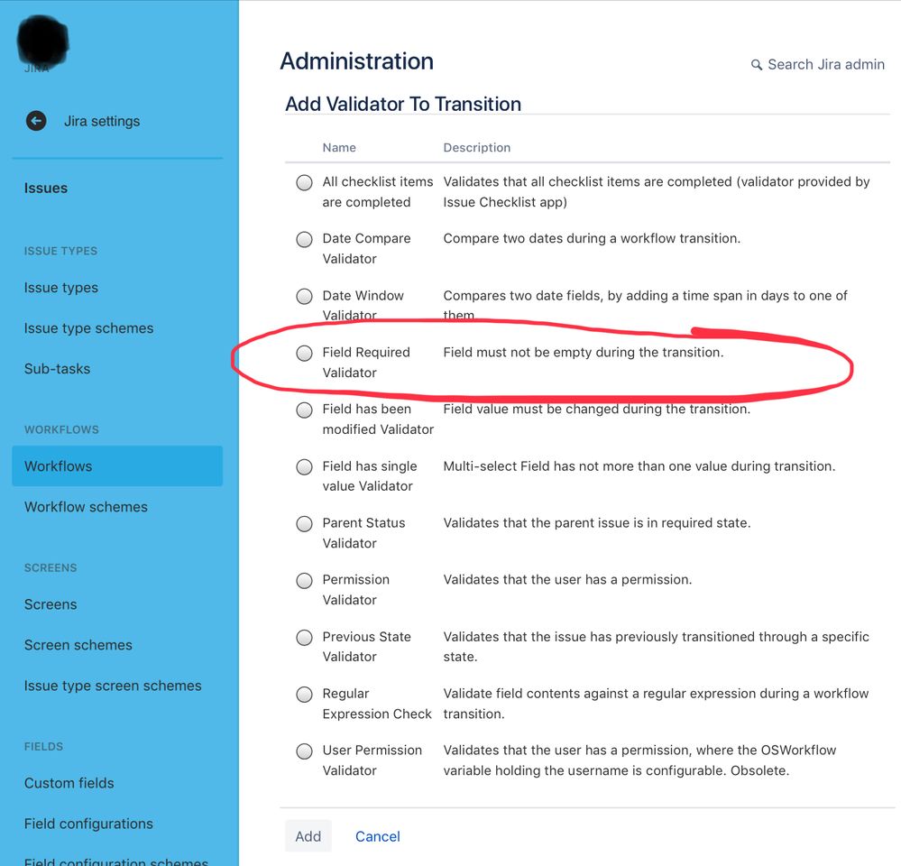

Yes. The best way is to use a Validator on the Create transition in the workflow. Edit the workflow, open the Create transition and click on Validator then add Validator. Use the custome Issue field required function.

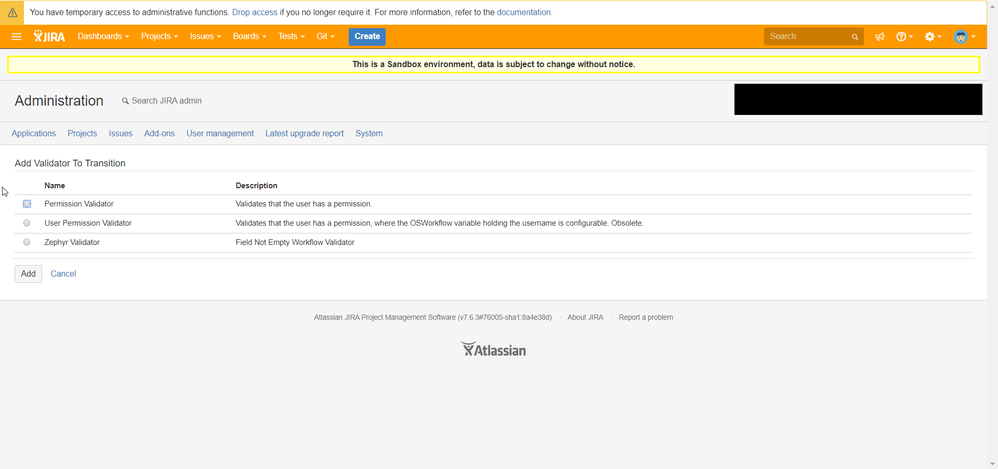

Thank you for the reply. I am not able to see the validator for custom field. Please help. Thank you!
I believe we need to install the JSU (JIRA Suite Utilities) to make it work. How about creating new field configuration schemes? Thank you!
Sorry I misspoke here. Use the Field required Validator. Yes add JSU.
