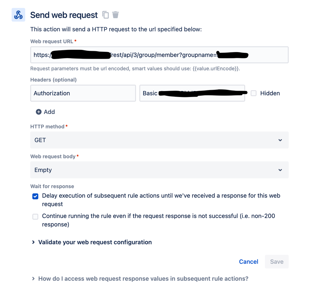

I am loading the list of members of a group, then creating one issue for each of them through automation.

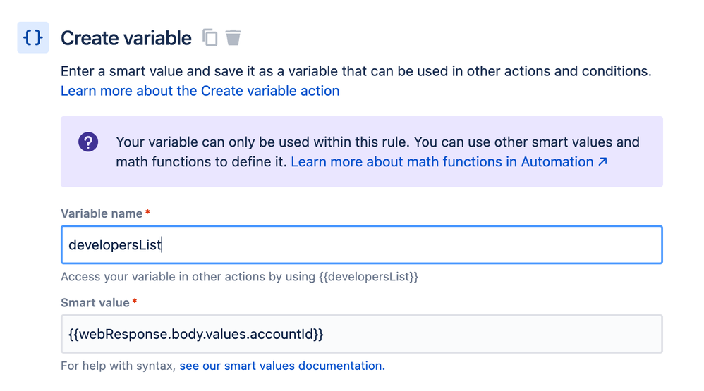

Next step is creating the variable

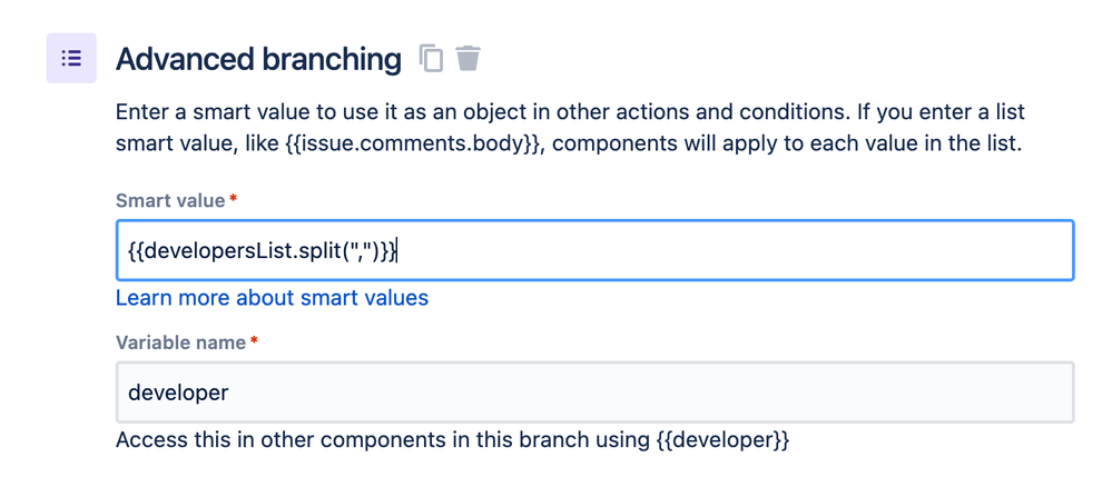

I then loop through it with

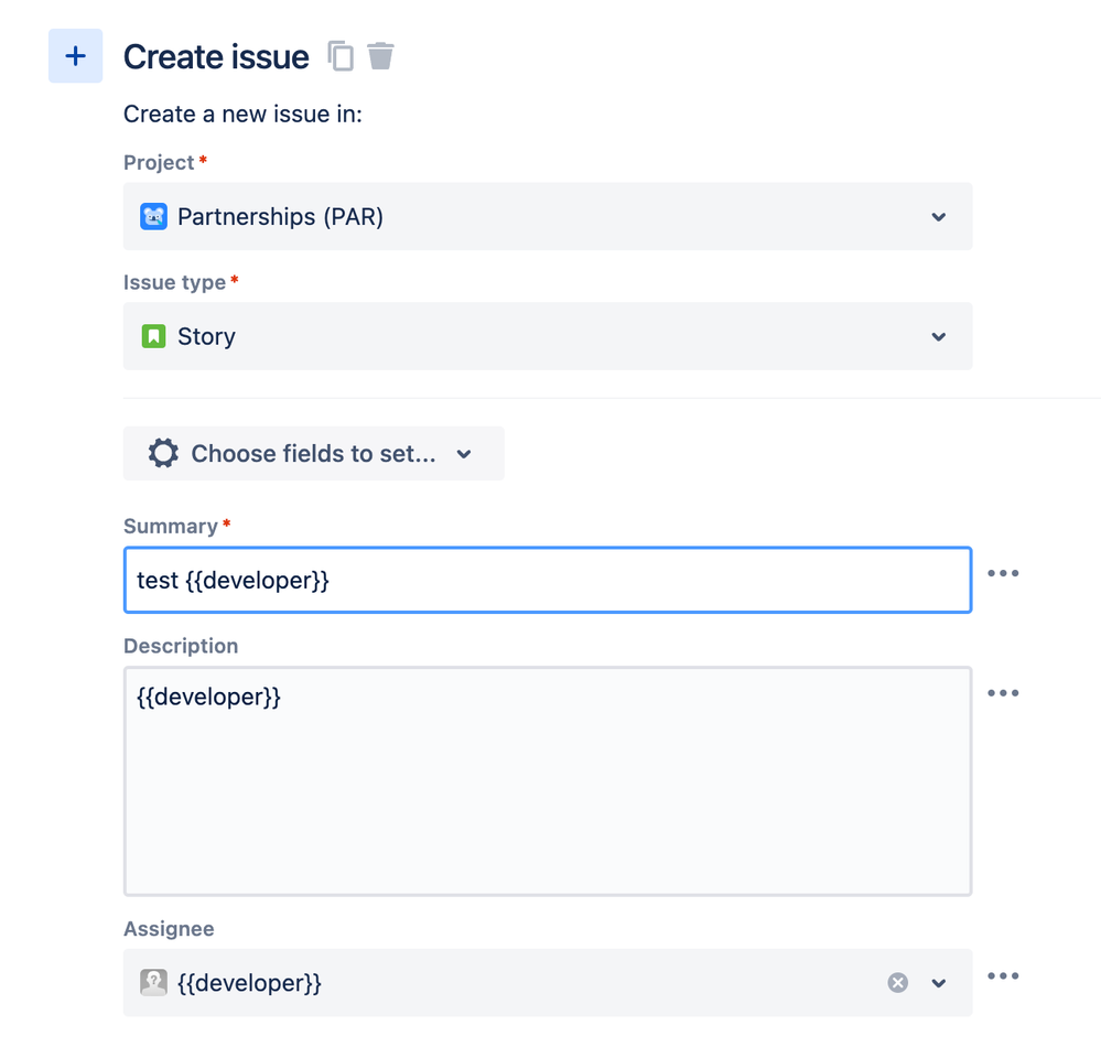

And within the branches I create the task using

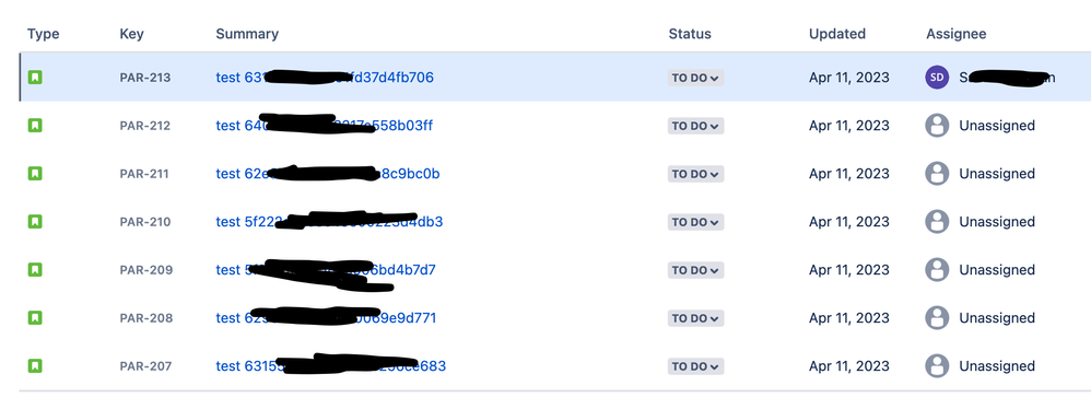

And the result is below:

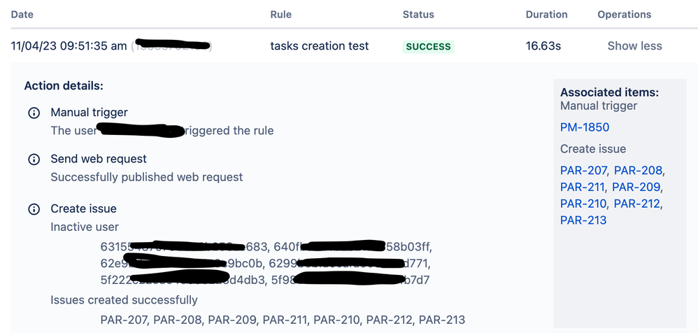

with the audit log as below
As you can see it has worked as expected except for the assignments where it has only been successful for one user (cf inactive user warning in the audit log). I have checked the result payload and all users are marked as active and I know for a fact that the accounts are all actively used daily.
Any idea why this is happening or how I should change the way I process the list ?
EDIT: I have tried with several groups and the last member is always the one which is correctly processed (last = highest issue key PAR-213 in my example)

I believe the problem stems from splitting on "," rather than ", " which is the joining sequence.
Given the string of "id1, id2, id3"
Splitting on "," produces ["id1" , " id2" , " id3"] producing one valid id ("id1") and n invalid ids with a trailing space. Splitting on ", " or calling .trim() on each element of the list should solve this as well. But as said, iterating over the original data is safer and less error prone than joining the values to a string which is then splitted again to iterate over.

TP
April 11, 2023
I tested for this by outputting the string in description but it must trim it automatically there because there was no extra space.
Good  catch!
