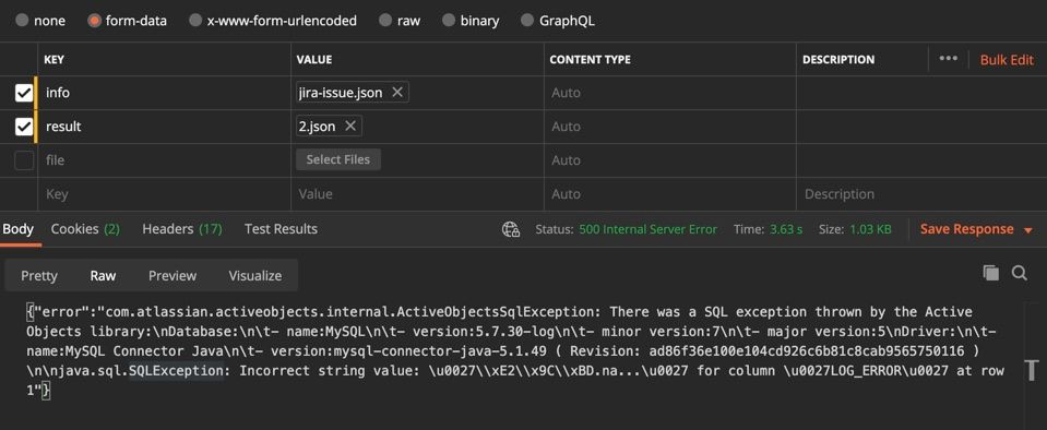

We are also trying to feed the JSON files to JIRA using the https://jira.xxx.dom/rest/raven/1.0/import/execution/cucumber/multipart REST API endpoint. Some uploads (which are quite small in size) are working successfully but for most of the larger reports I am getting the following error.
{"error":"com.atlassian.activeobjects.internal.ActiveObjectsSqlException: There was a SQL exception thrown by the Active Objects library:\nDatabase:\n\t- name:MySQL\n\t- version:5.7.30-log\n\t- minor version:7\n\t- major version:5\nDriver:\n\t- name:MySQL Connector Java\n\t- version:mysql-connector-java-5.1.49 ( Revision: ad86f36e100e104cd926c6b81c8cab9565750116 )\n\njava.sql.SQLException: Incorrect string value: \u0027\\xE2\\x9C\\xBD.na...\u0027 for column \u0027LOG_ERROR\u0027 at row 1"}
If these JSON files are used to create an issue manually in JIRA, everything works as expected

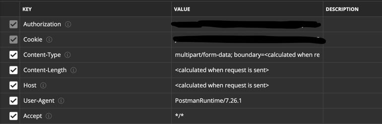

Here is how I have Postman setup:
C7B990D8-8436-4CBF-A969-BAC5CFFB6DD7.jpeg6CACACEB-76E8-4AC1-B17B-64FB75C81F42_4_5005_c.jpeg
