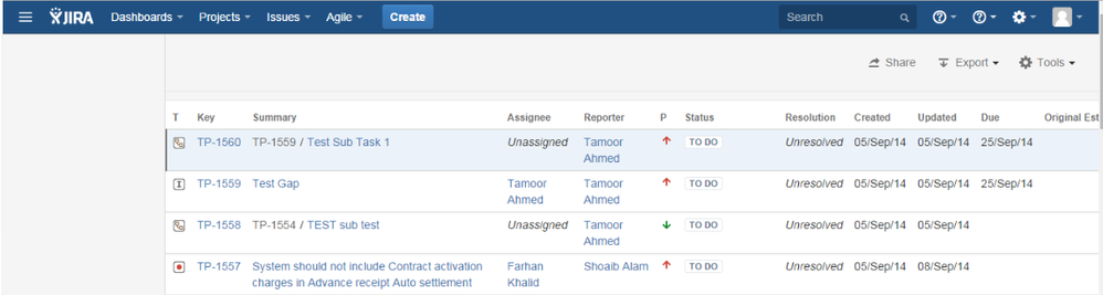

When you go to the Issue search/issue navigator, it appears to be completely broken. There's no way to search. The only buttons available are "Share", "Export", and "Tools" and they don't do anything when clicked.
This issue occurs only for the single user. Rest of the users are able to access the JIRA Header Dropdown options like if we select Project on Header then the list of projects will be displayed by dropdown.
If we select Dashboard on Header then the list of Dashboards will be displayed by dropdown.
If we select ISSUES on Header then the list of Issues will be displayed by dropdown.
But for the particular user is unable to view the header dropdowns. I have checked the permissions everything is perfect.
But am not sure why she is unable to view the JIRA HEADER DRP DOWN Options.
Please find the below snapshot.

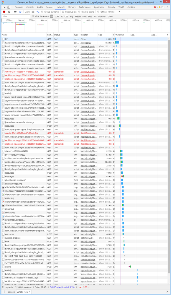

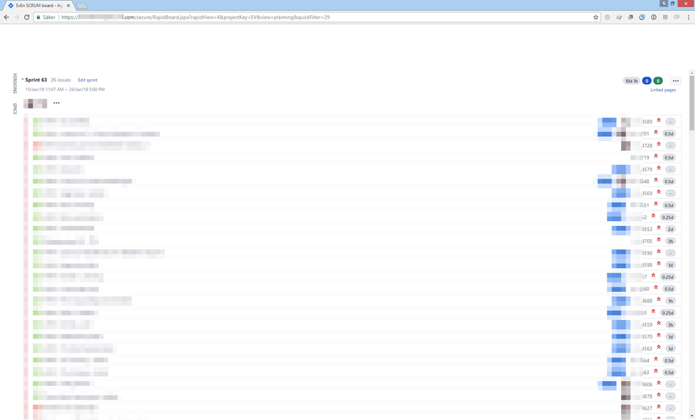

Mattias Lindgren
January 17, 2018
Hi!
The same thing happens for me since tha last few days:jira.png
In the network tab you can see that a lot of recources has not been loded.
If I hit Ctrl + Shift + R or if I disable cash the menu and side panel are loaded.
Any suggestion on how to solve this?
