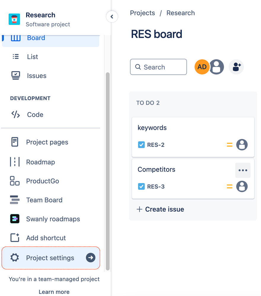

First, from your project board/timeline, scroll down on the left column and you should find the Project settings tab.

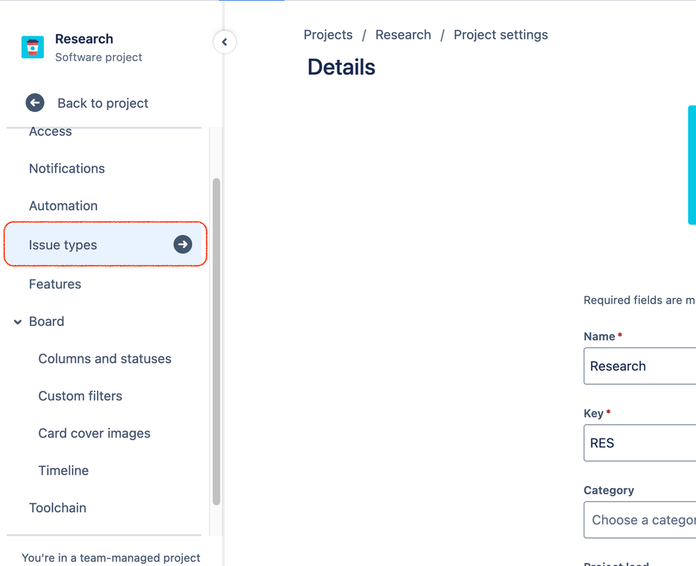

Then, click Issue types.

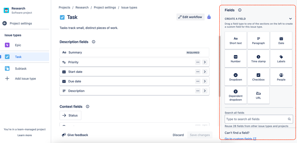

Now you can add more fields (on the right column) to your Jira tickets, whether Epic, Task, or Subtask (depending on which type you configure for your project).
Drag the one you need to the Description fields section.
Once done, you can save changes and go back to your Project timeline to see if it is updated.
