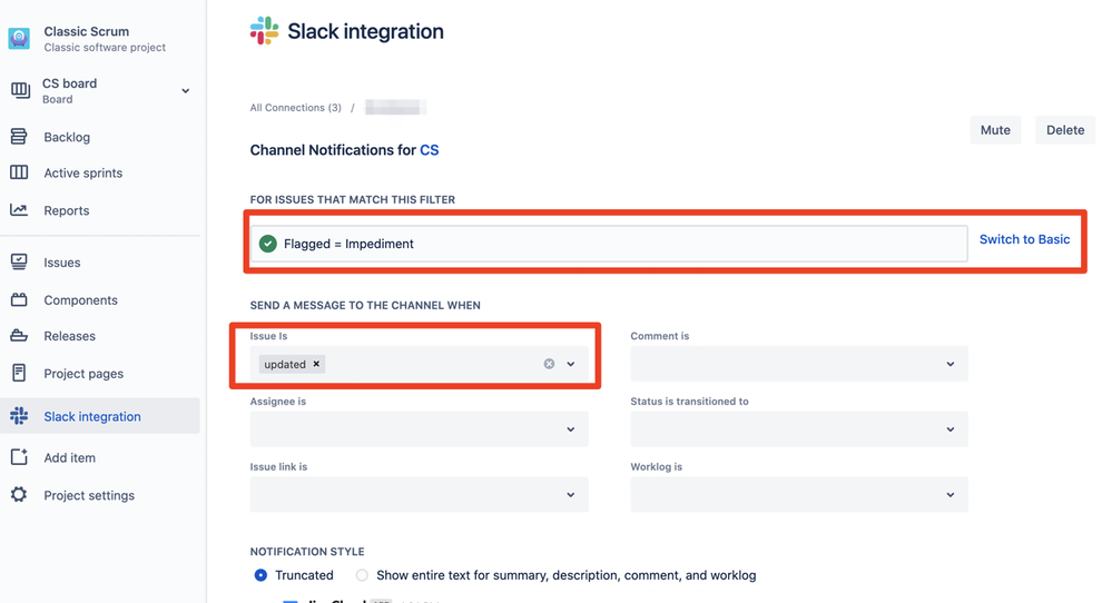

  1. Jira Cloud for Slack is the standard Slack integration and accessible from the "Slack integration" option in your project's settings. From there, you can use this filter to fire a notification when an issue is flagged to whatever channels you need:
    JQL Filter: Flagged = Impediment
    Issue is: updated

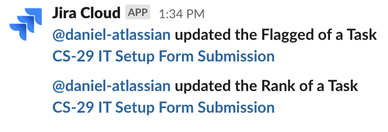

    The caveat here is that if the issue is updated while it is still flagged, more notifications will be triggered. For example, after flagging an issue with this method, I then re-prioritized it in the backlog, and a second notification was triggered:
