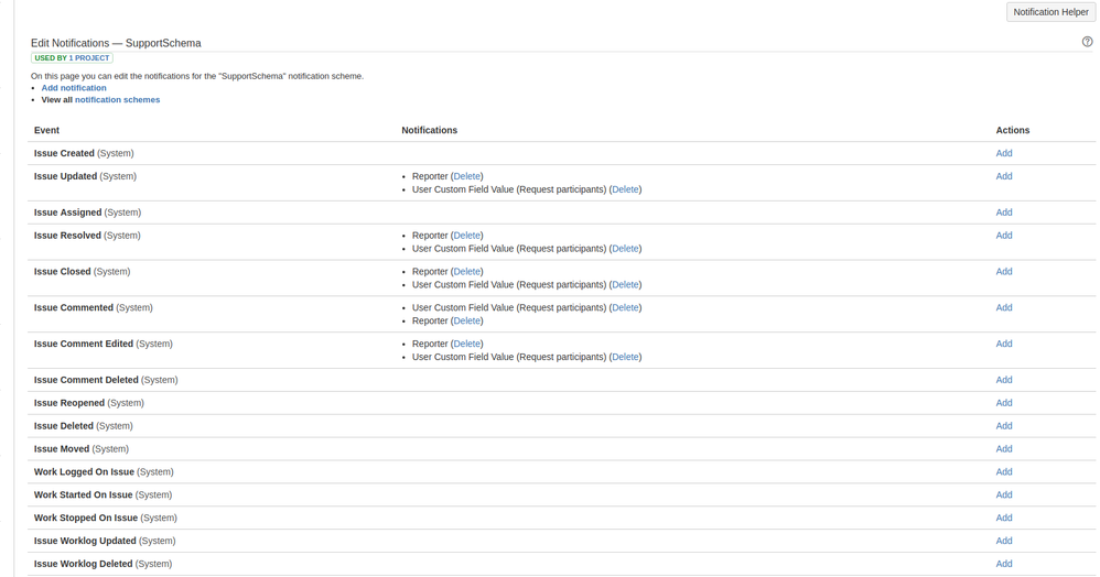

I recently updated JIRA Service Desk to 3.9.0. After update JIRA don't send customer notification when we change issue status and send if issue commented.
Below notification settings:

The screenshot you posted is of the Jira Core notification scheme.  Service Desk customers have never been notified via those settings.  Those specific setting are only for sending notifications to Agents or other Jira Core/Jira Software users that might be involved in that issue.
This distinction is also explained in JIRA Service Desk Notification explanation.
