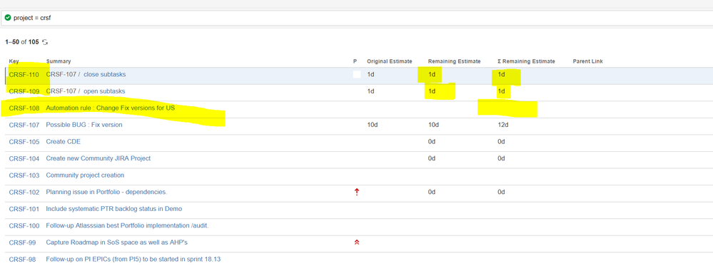

Hello Team,
Can we have the sum of remaining for all tasks and sub-tasks for a US in the field SUM of Remaining ?
We noticed that the field Sum of remaining in the reports does not show any value....
Thank you

Hi Nic,
Σ remaining estimate" field does not show the sum in our plan.....
for example if a
US 1 = 3 md
with 3 subatasks with 1md each
=> Σ remaining estimate does not show any value !
is that normal ? or it's a BUG in JIRA ?

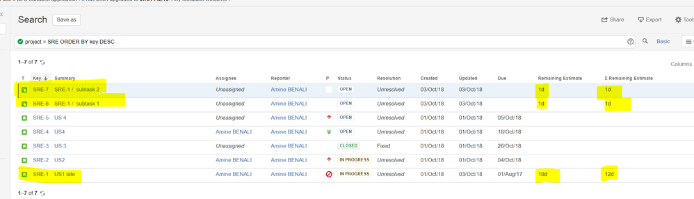

Hello Nic,
I think it's an issue on our platform in Production...Σ remaining estimate works well on the staging as shown by these 2 screenshots.
to answer your question yes, we are using time tracking
Nic Brough -Adaptavist-
October 4, 2018
Hmm, ok, so it works in staging, but not production.  That definitely needs to be something fixed on production, but I can't think of a way to hide the field like that.
