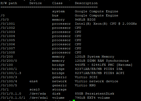

Our Jira Instance(8.1.3) took ~6 Days for a lock and reindex. However, lock and reindex in safe mode is taking just 30mins below are the screenshots for the database statistics and hardware info. Can someone help me in troubleshooting this issue?
