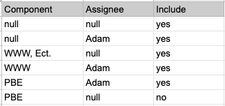

No I don't think you have.  Here is what I want:
  • I want everything from (filter = 23266 OR project in (WD, WC)), but:
    • I do NOT want the ones where assignee is empty and component is PBE.
    • I do want the ones where assignee is empty and component is empty.
    • I do want the ones where assignee is set and component is PBE.

Thanks for the help on this Nic.  The above solution is still not quite right.  It misses items where the component is something other than PBE and the assignee is not empty.

So this illustrates what I'm going for.  I think there is an answer here based on your solution.
Adam Youngers
January 21, 2022
@Nic Brough -Adaptavist-  - So I think I have a modified solution based on yours and the grid above.  It's not pretty, but it does do what I was looking for:
