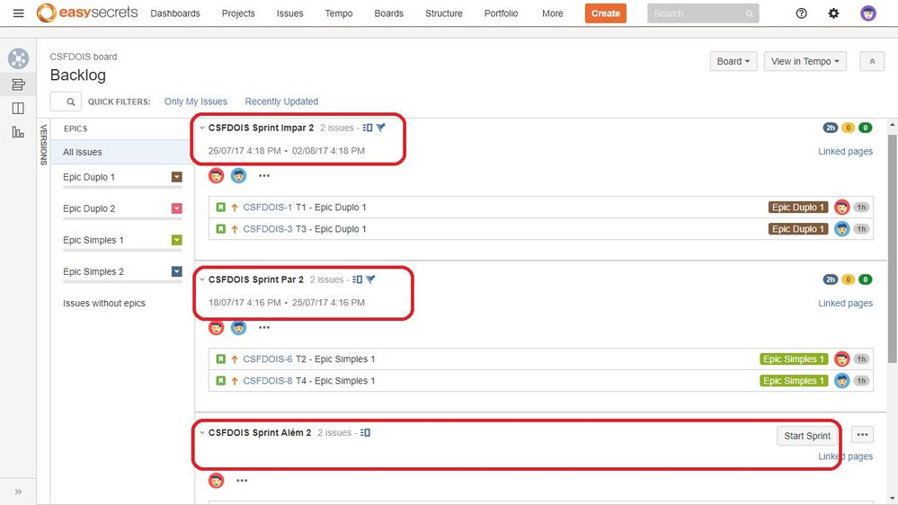

I have a JIRA Portfolio configured to use two Scrum Boards.
While my Sprints DON'T have start and end dates, everything goes right, but at the moment that I start the Sprints and assign starting and end dates to them, JIRA Portfolio becomes inconsistent.
See the attached image:

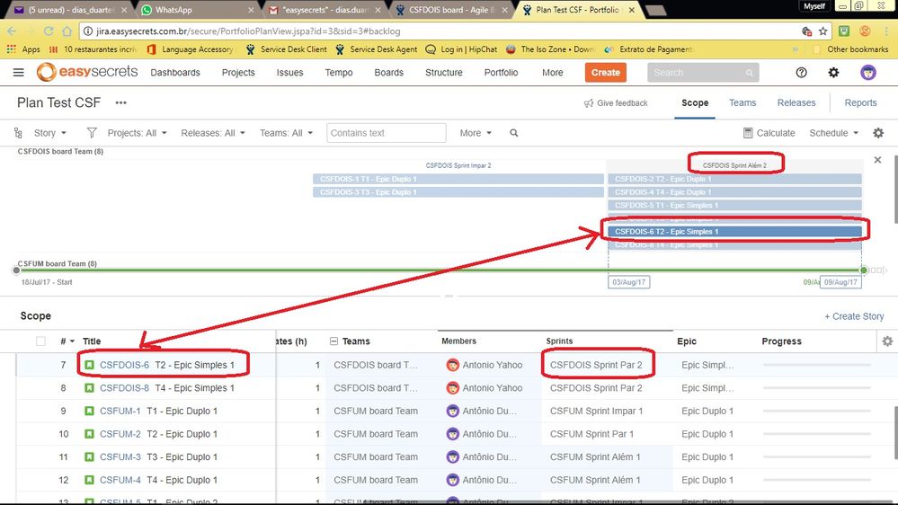

The issue CSFDOIS-6 belongs to the Sprint "CSF2 SPrint Par 2" in my original Board Scrum. This is correctly shown by JIRA Portfolio in the lower half of the screen.
BUT, if you see at the upper half of the screen, JIRA Portfolio puts this same CSFDOIS-6 issue wrongly in the Sprint "CSF2 Sprint Além 2".
The only difference is that Sprint "CSF2 SPrint Par 2" has start and end dates, but Sprint "CSF2 Sprint Além 2" was not started yet.
And as if this was not enough, see that according the start and end dates, Sprint "CSF2 SPrint Par 2" SHOULD be visible in JIRA Portfolio screen BEFORE Sprint "CSF2 SPrint Impar 2", but it was not put there by JIRA Portfolio...
Can anyone help with these problems?
Thank you very much.
AntonioBoard Scrum com os Sprints.jpgIssue schedulada em Sprint incorreto.jpg

I don't have my plan configured this way, so I'm kind of guessing.  I would first try simply clicking the Calculate button.  Portfolio doesn't seem to always calculate the plan and show it correctly whenever the page loads.  My second guess is that it looks like you started the sprint CSFDOIS Sprint Par 2, even though it hasn't reached the start date (since it's missing the Start Sprint button).  Normally Portfolio will show dummy sprints for planning purposes and they're just named Sprint 2, Sprint 3, Sprint 4, etc.  I don't know how it handles a started sprint where the start date hasn't been reached yet, but that's my guess as to why that sprint is missing from the plan.

I would delete the future sprint you had started and recreate it first, just to confirm that is the reason why it doesn't show up in your plan's timeline.
Otherwise I would just let Portfolio manage the dates for you.  Assuming you do consistent iterations it should work fine.  It takes the current sprint's end date and starts Sprint 2 a day after, Sprint 3 two weeks after that, and so on.  You can check these dates in Portfolio by clicking the sprint in your timeline view (in your second screenshot where you have "CFSDOIS Sprint Alem 2" circled).
