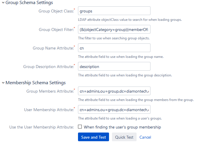

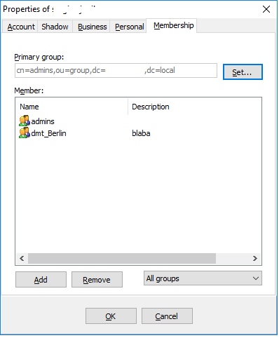

Here are my group and membership-settings in Confluence:
Here the Primary group (dc= I've deleted for privacy reasons)

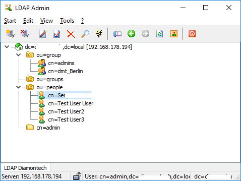

And here my tree from a windows config tool that is connected with my linux server (also here dc= deleted for privacy reasons..)
the string I put into the Group-Object-Filter field is:
(&(objectCategory=group)(memberOf:1.2.840.113556.1.4.1941:=cn=admins,ou=group,dc=diamontech,dc=local))
Can you see the mistake?
