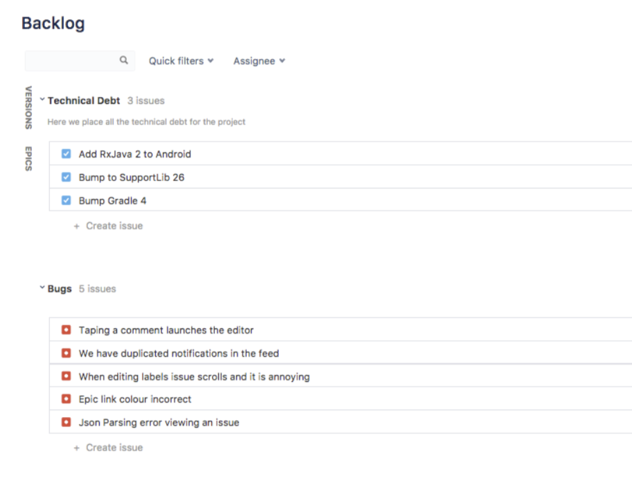

- I am looking for Group By because I wanted originally to group issues in the backlog visually based on certain categorizations such as short-term, mid-term, and long-term. Or maybe other categorization (Feature-request, Tech Debt, Customer-Request, ..etc.). I didn't find a native way in Jira software to do this. I have seen you replied in other threads that I can't add fields (or columns, whatever you name it) based on an attribute attached to an issue. So, I thought to do a JQL filter and group by 'label' as a workaround. Now, you tell us this is not possible as well. If you can help me in this, I would be thankful.
Update - I need to have something like this (but please don't tell me to create fake sprints, because this is short-and-dirty workaround!)
- Please try to understand customers' needs and requests. Honestly, I didn't like your blunt responses and replied in many threads. I mean it. You give customers harsh replies such as 'useless' or 'you don't need it'. Please give some respect to customers' needs. Even if we don't understand the product and you are the expert, you should help us achieve what we need, not educate us how to do work. As a product manager in enterprises for more than 10 years, I think that some responses you give are not the best you can give to customers. Don't' take it personally. I just see myself can't go silent while you jump from one thread to another shutting off customers just because they need a feature to manage their work.

Nic Brough -Adaptavist-
November 25, 2020
You would need to rewrite the screens and code that renders the backlog, and bear in mind that this would destroy your ability to rank the issues.
