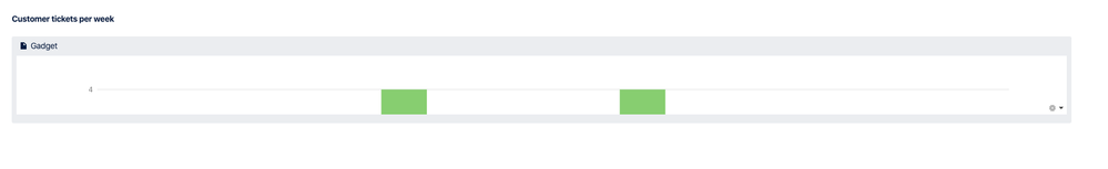

For some reason, our gadgets are just getting cropped off on our dashboards. When editing the gadget, you can fully see the intended result :Screen Shot 2020-03-17 at 9.56.34 AM.png
However, after saving this result, it populates only 10% of the content:
Not sure what's causing this issue, as I've tried to use multiple incognito browsers, fiddled around with the settings, and re-creating the dashboard to no avail. Any tips would be greatly appreciated!

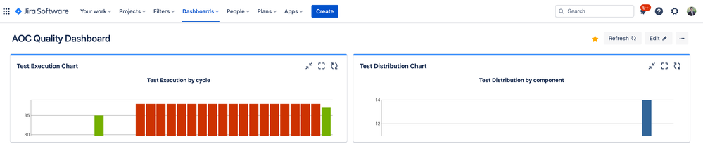

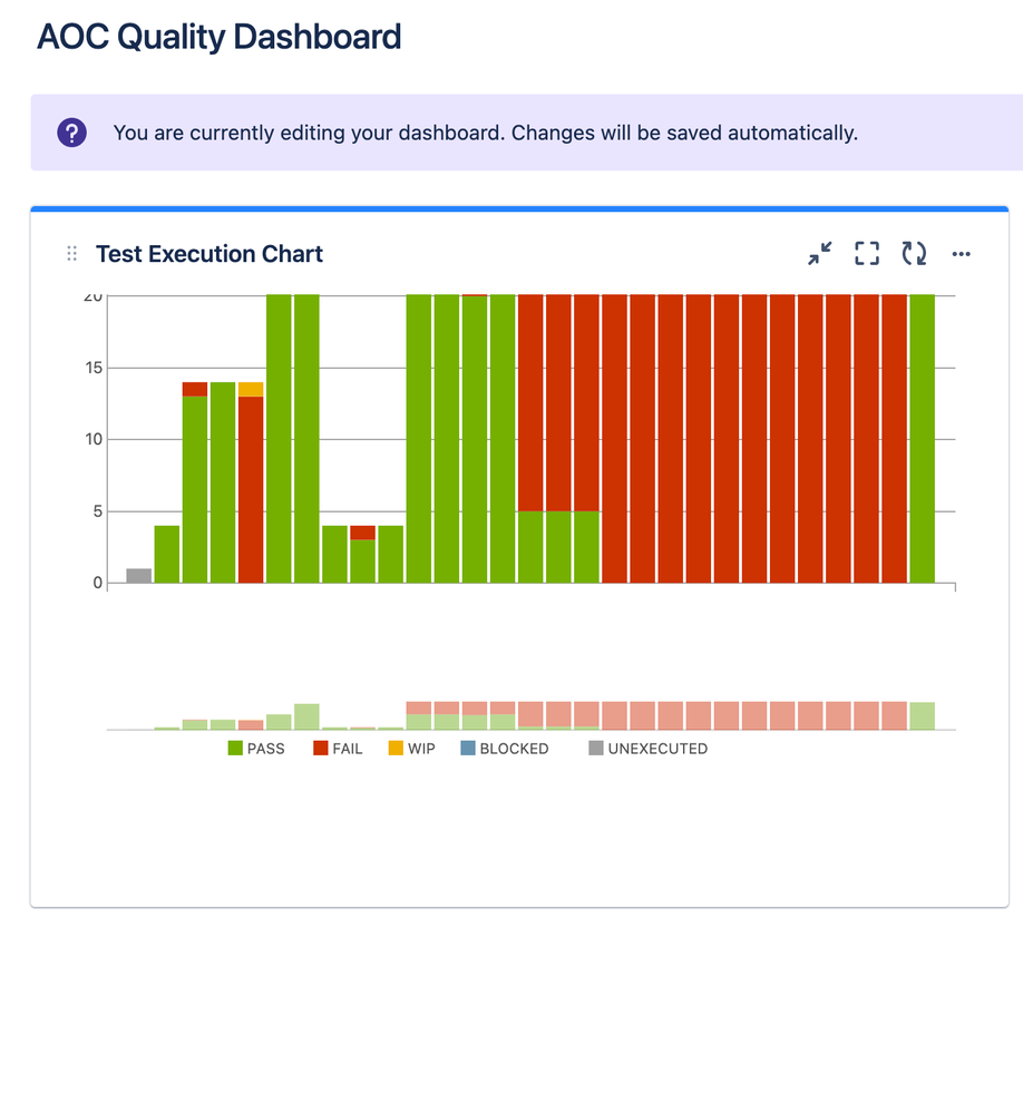

Was this resolved? I created dashboard using gadgets for Zephyr test results. I see that the dashboard is always cut-off - just shows the top 15-20%. It used to work fine in Jira Cloud 2 years ago when I first used dashboards.
Even in the edit mode, it shows only 50% of gadget, I think the resize should happen for every 10 tests automatically as opposed to 5:

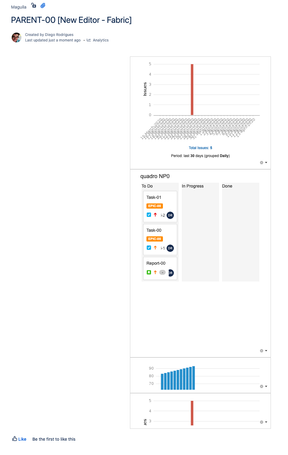

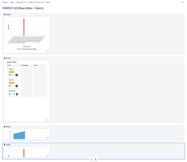

Working my way around this issue, I am able to reliably replicate the behavior. The issue we are facing is the one under the Bug Report I linked earlier.
Here, take a look:
And here you can see how it looks like on my end:
Edit Mode:
View Mode:
Here is an excerpt from the bug report itself:
When multiple Jira "Gadget" macros (particularly, the "Agile wallboard gadget" and the ‘Jira Issues Calendar’ macro) the gadget macros that are below will end up with a reduced viewable area without being able to scroll through to see the full rendered output.
The behavior is also present when I use the "Created vs Resolved macro", which is the macro being used above the problematic ones in the video shared with us. The behavior present in the shared video and what I was able to replicate do match the bug report.
Currently, as described in the report, there is no workaround or solution to the issue. The best course of action would be to vote and watch this bug report. Voting for it helps to increase the issue visibility and watching it will keep you up to date with everything posted there.

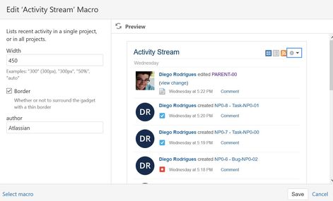

On my side, here what an Activity Stream looks like in Confluence:
Also, here is the documentation for the Activity Stream macro for both Cloud and Server:
Again, thanks for keeping the thread alive! Looking forward to your reply.

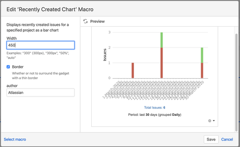

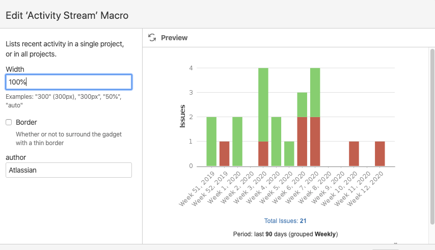

I have checked both the New Editor (Fabric) and the Legacy Editor (tinyMCE). In both of them, the macros display as expected. I have checked for the behavior in the following environment:
  • Windows 10 version 1903
  • Firefox 74.0.1 64-bit
  • Opera  67.0.3575.115
  • Chrome Version 80.0.3987.149 64-bit
I used both proportions shown in your macros (450px and 100%). Both of them displayed correctly. When I used the 100% one, I had to decrease the display size of my page to about 40% so the whole macro would display. Here is what I saw:
While editing the page:
While viewing the page:
Out of curiosity, what browser and operating system are you currently using? I would like to try and replicate that behavior in an environment that closely resembles yours.
