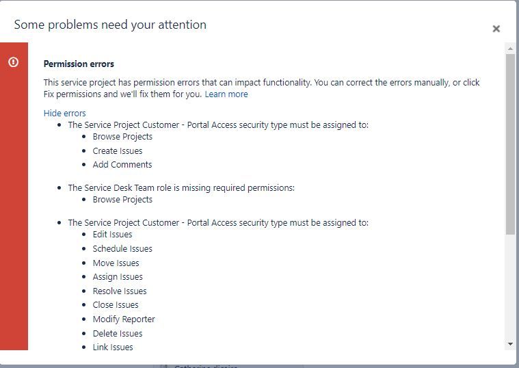

As an admin, if I remove every authorization related to the customer portal, should I still see it?
Catherine.dicaire
May 20, 2021
It end up giving me an error message :
I have the option to «Fix issue» which only revert back the change I made to the authorization for the project and doesn't help me at all...
