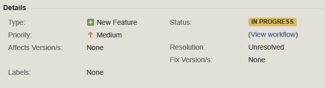

I want to use JIRA Cloud REST API put fixversion to many issues.
I read JIRA Cloud REST API doc and used code litke this
curl -X PUT --data "{ \"update\": { \"fixVersion\": [ { \"add\": \"0.0.3\" } ] } }"  https://$USERNAEM:$PASSWORD@$net/rest/api/2/issue/$issueid
 % Total % Received % Xferd Average Speed  Time   Time  Time Current
Dload Upload Total Spent Left Speed
100 54 0 0 100 54 0 52 0:00:01 0:00:01 --:--:-- 53
but nothing happened

-------------------------------Update(8/28)------------------------------
I added '-H "Content-Type: application/json"'
#!/bin/sh
curl -u $USERNAEM:$PASSWORD -X PUT -H "Content-Type: application/json" --data '{"update": {"fixVersions": [{"add": [{ "name": "0.0.2"}]}]}}' $URL
and got error message
{"errorMessages":[],"errors":{"fixVersions":"Could not find valid 'id' or 'name' in version object."}}
