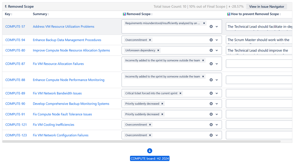

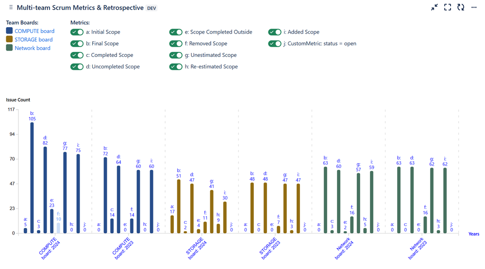

Hi @Riyas Khareem ,
Did you try the Sprint Report? Or you need to collect the Removed Issues from over 7 sprints? If you need to collect the Removed Issues from over 7 sprints, the only consistent way is to use the JIRA REST API or 3rd party app. The app I have developed - Multi-team Scrum Metrics & Retrospective - has this capability. You can track it for over 7 sprints, or even across months, quarters, half-years, or years.

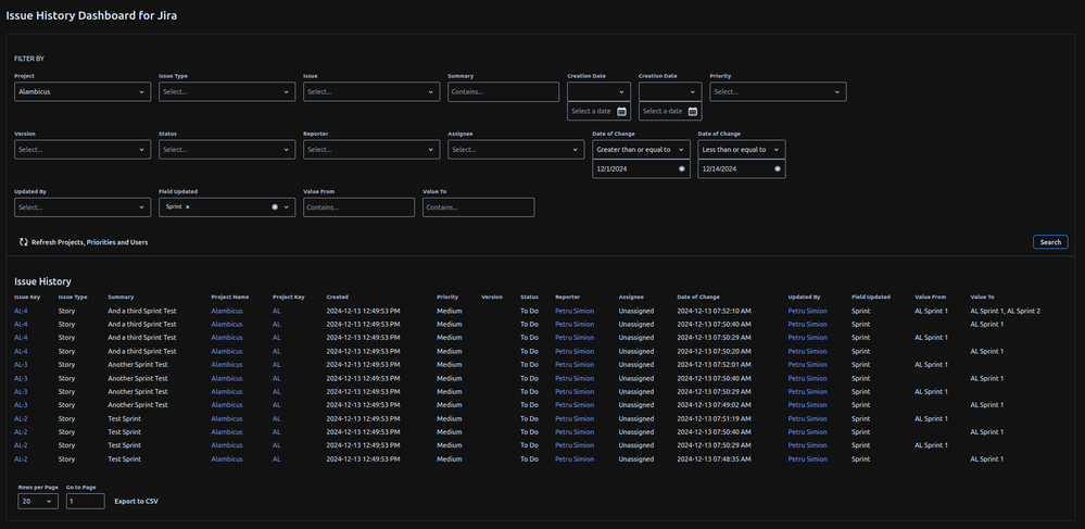

Hi @Riyas Khareem ,
If you are open to using apps, you can use Issue History Dashboard for Jira, an app recently released by our company.
https://marketplace.atlassian.com/apps/1235591/issue-history-dashboard-for-jira?hosting=cloud&tab=overview
You can filter your search for Updated Field to be Sprint and the Date Updated from and to to be your desired sprint start and end dates.
The Value From and Value To columns are displaying the changes. If the Value To is empty it means the issue was moved out of the sprint.
You can also export your search to CSV.

Petru Simion _Simitech Ltd__
Atlassian Partner
December 13, 2024
@Riyas Khareem
