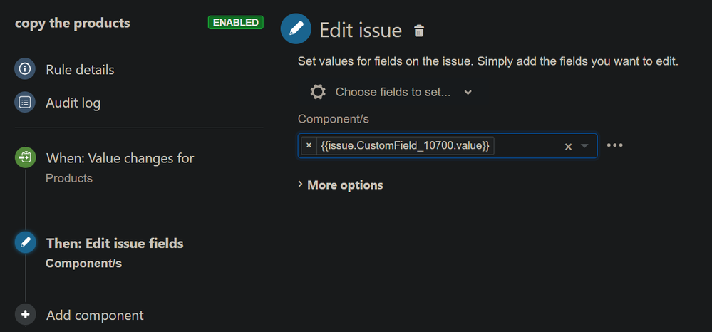

Rémy PREVOT
July 19, 2021
Hello
I find the solution. Here is the smart values to use :
For simple list :
{{issue.CustomField_xxxxx.value}}
For cascading list :
{{issue.CustomField_xxxxx.value}} ==> parent value
{{issue.CustomField_xxxxx.child.value}} ==> child value
*xxxxx refers to the id of the custom field
Hope that will help !

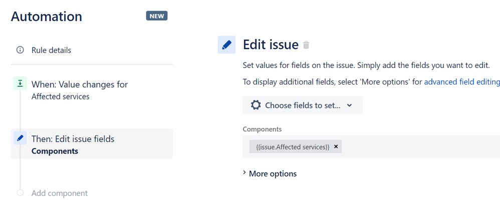

Dave Bosman _Inetum_
July 13, 2021
Hi @Rémy PREVOT
You should use a smart value
In my example it is done with the field "Affected services"
Regards
Dave

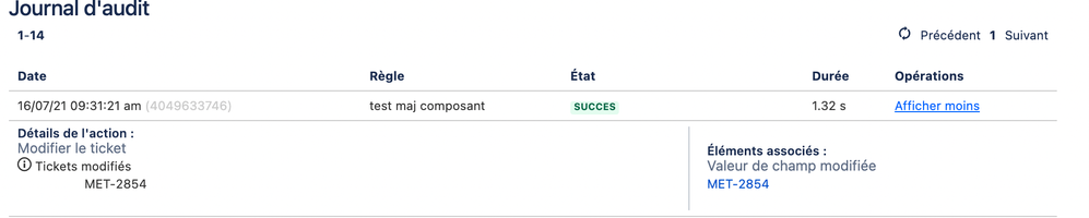

Could you share a screenshot of the audit?
Also, the user that is executing the rule, does he have permissions in that project?
Rémy PREVOT
July 16, 2021
@Dave Bosman _Inetum_ ,
The user is the admin and we gave it all the necessary permissions on the project.
Here is the screenshot :

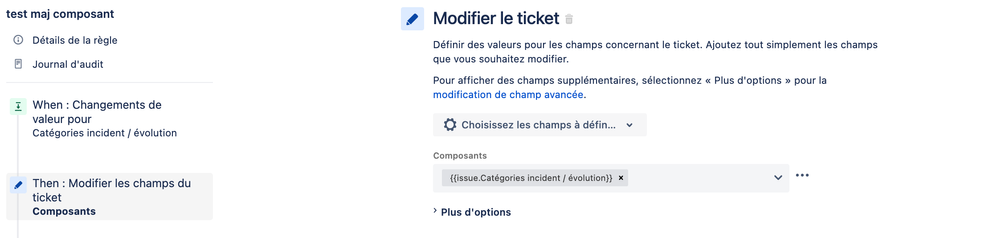

Here is a screenshot of the modification :

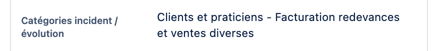

Screenshot of the result :

Regards,

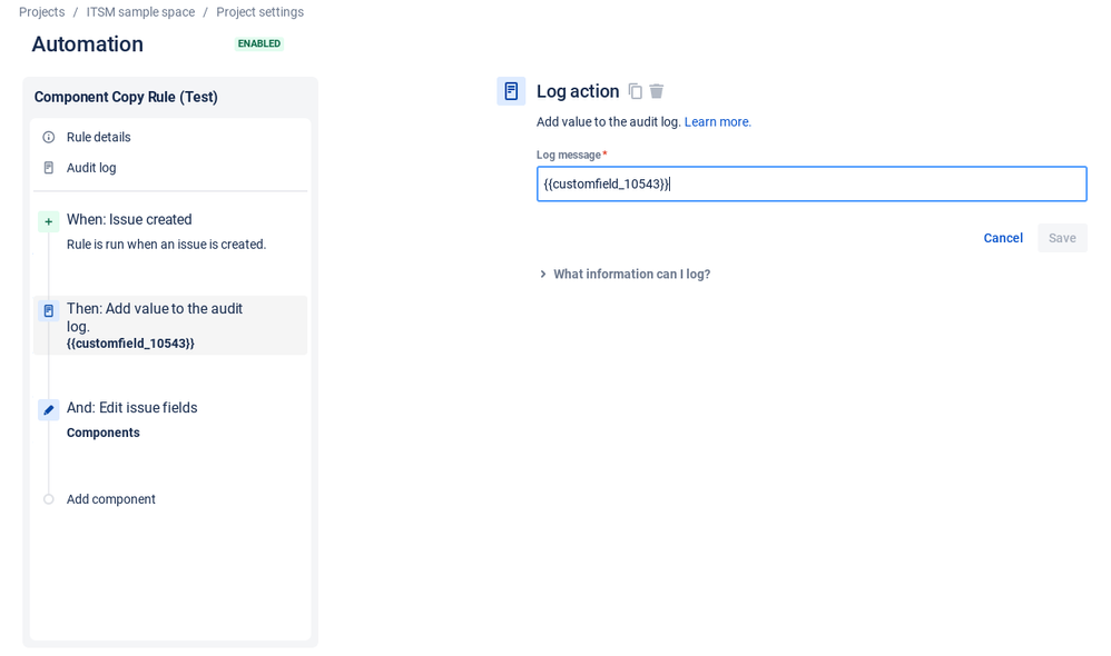

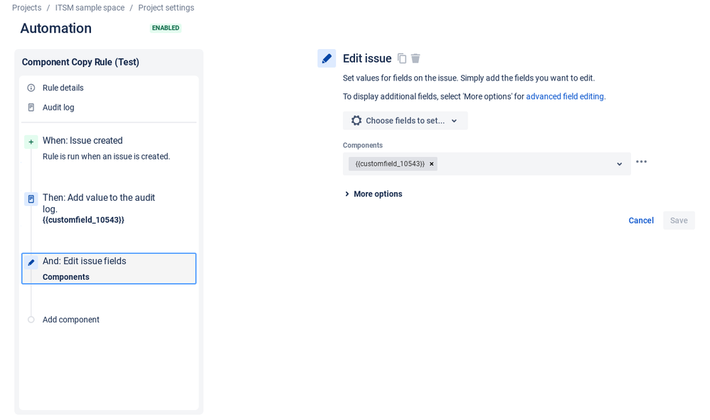

Sam Ayres
August 1, 2023
Hello,
Try storing the value with the "Log action" action, and then call upon the value that you stored in the next step in order to edit the "Components" field.
