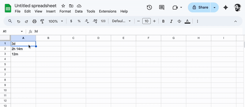

Alternatively, if you're looking for an immediate solution, you may want to have a look at the app that my team and I are working on: JXL for Jira.
JXL is a full-fledged spreadsheet/table view for your work items (issues) that allows viewing, inline-editing, sorting, and filtering by all your work item fields, much like you’d do in e.g. Excel, Google Sheets, Smartsheet, or Airtable. It also comes with a long list of advanced features, including support for inline bulk editing via copy/paste. This works within JXL, but also across JXL and pretty much any other app, including e.g. Excel or Google Sheets.
This is how it looks in action:
JXL generally accepts any value as it would be entered directly in Jira. So if there's a way for you to easily get the data into this shape, this could be a quick and easy workaround.
I should also add that JXL can do much more than the above: From support for configurable work item hierarchies, to work item grouping by any issue field(s), sum-ups, or conditional formatting.
