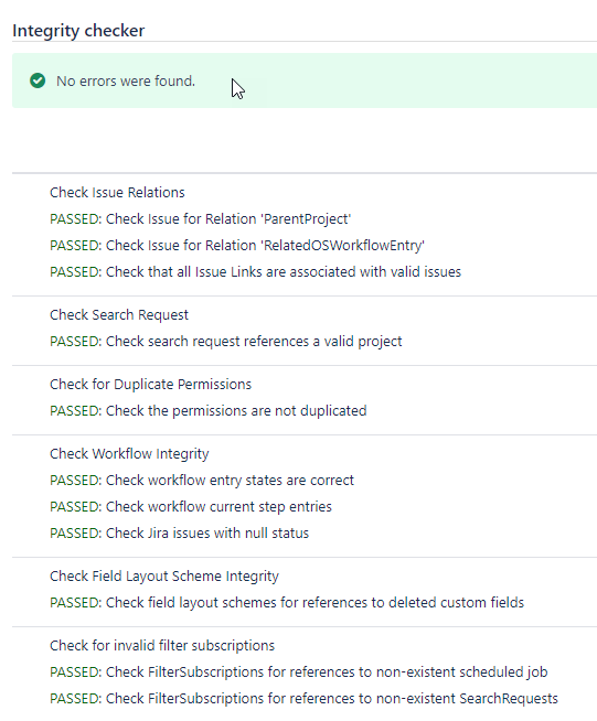

Randall Williams
January 4, 2021
Daniel Ebers
January 4, 2021
The integrity checker would not be able to diagnose this kind of issue - to my knowledge.
Have you had a look into atlassian-jira.log if anything related to this can be spotted?
Daniel Ebers
January 4, 2021
There are some errors which I were not able to find a root cause for using knowledge base.
Also this one: https://confluence.atlassian.com/jirakb/jira-throws-nullpointerexception-in-issue-navigator-867013154.html
makes sense but in your case Integrity Checker is not able to find anything related.

December 31, 2020
Randall,
  Is this happening for all users?  Does it happen in all browsers?  Have you cleared your browser cache since you upgraded?
Randall Williams
January 4, 2021
@Brant Schroeder
A. Yes, all users
B. Yes, all browsers.
C. Yes, cache cleared.
Brant Schroeder
January 4, 2021
What version did you upgrade from?
