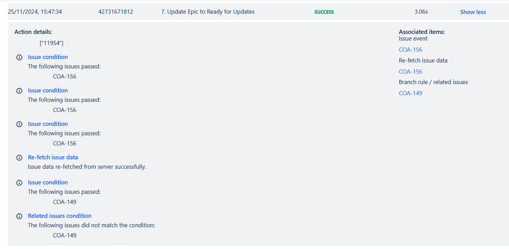

However, the automation gives an error saying "The following issue did not match the condition" followed by the parent-id which we would like to transition.

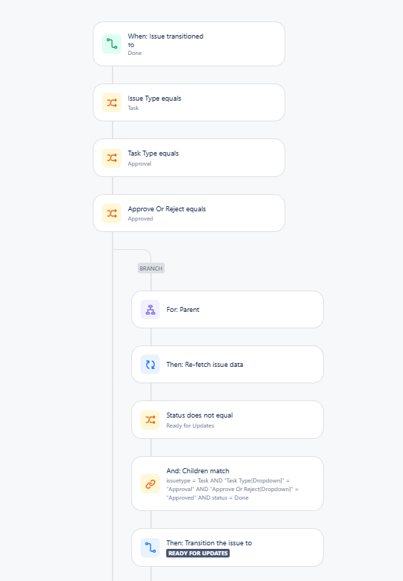

Screenshots attached with the Automation and Audit logsScreenshot 2024-11-25 160037.pngScreenshot 2024-11-25 181359.png
As per the Automation, the expectation would be for it to work as below.
1) Trigger
Once a Issue is transitions to "Done"
2) If the issue type is "Task" and then validate custom fields "Task Type" and "Approve or reject".
3) Check the parent issue of the Trigger
4) If the Parent status is not "Ready for Updates"
5) Check the related issues (Children) of the parent issue under the branch as per the JQL
6) Transition the Parent issue to "Ready for updates".

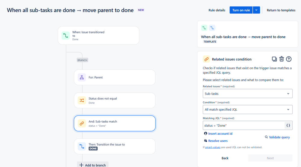

This is based on a Template (see attached).

Would you please repost the audit log details for the rule?
The image you show is not for the rule as the audit log shows a call to the Re-fetch Issue action and that is not in your rule.

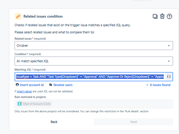

Also please post an image of the Related Issues condition you are using.

I've uploaded the correct screenshot of the Automation which has the "re-fetch issue data"
Here's the JQL used: issuetype = Task AND "Task Type[Dropdown]" = "Approval" AND "Approve Or Reject[Dropdown]" = "Approved" AND status = Done
Here's the validation result of the JQL, which shows correct results.

What is the purpose of the Re-fetch Issues action in your rule, as I do not believe it is needed for this scenario?
Next, have you tried that JQL standalone (for example, adding AND parent=COA-149) to confirm the results match what you expect?
If they do, perhaps try another approach, as I have observed the Related Issues condition not working as expected for options like "Children".  (We really do not know what the automation is adding to the JQL behind the scenes as that is undocumented.)
For example: use a Related Issues condition with JQL to fully control the expression, and invert the test
  • Related issues: JQL issues
  • Related issues JQL:
parent = {{issue.key}}
AND issuetype = Task
AND status != Done
  • Condition: are not present
