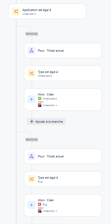

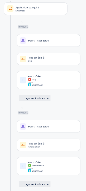

The first screenshot represent rules that don't work in comparison with the 2nd one where things work.
The rule are applied on the ticket of the same project.
To be more precise, the rule must check the field "Application" and should create a ticket in either one of 2 differents projects (Lineavision+ and Lineatrack) depending on the application.
But it is exactly the same rule.

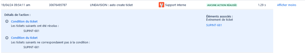

Thank you. And now for the Audit Log details for when it fails?

Here are the details for the last failure
John Funk
April 19, 2024
You have 3 conditions in that first rule but the audit log is only showing that it went through two conditions.
So the Application field = Lineatrack and that passed.
But both branches should have fired and there would be two conditions mentioned. So, what is the issue type for SUPINT-681?

I have one condition on the application field (Lineatrack or Linevision+) and then it should enter branches and check the type : bug, Improvement or Evolution.
The SUPINT-681 is of type "Bug".

I think I just understood the problem.
It's because the different IF condition in the rule are linked by "AND".
So when the first condition "if Application is Lineavision+" isn't met, it stops there instead of checking wether the following condition are met or not.
