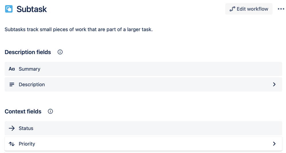

Hi @Gowri Kumar ,
May you check if Priority is in the screen associated to the Sub-task's create and edit issue operations?
Regards
Gowri Kumar
September 3, 2021
Yes, the Priority is associated with Sub-Task issue type, but I am using Team Settings instead of Company Settings.

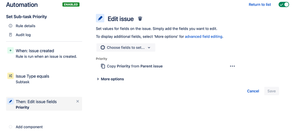

In the meanwhile, may you add screenshots of your Automation rule components?
Gowri Kumar
September 3, 2021
Thank you. Please note that if I set the priority value directly to a value (High or Low), it works. Only when I set to copy from parent it fails and throws an error.
