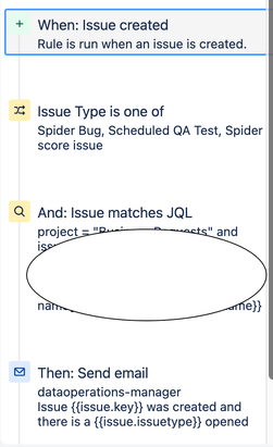

Hello, I need to create a rule that notifies me (by email) when a new issue is created and exists a ticket in other project where a custom field of the ticket created is the same, how can I create this?
I created one, but didn't work (the issue created if one of those issue types, and there is an issue that math the JQL, but in the log I got this: the issue didn't match the specified JQL (most likely), how can I set that I need exists one issue that match that jql and not the created one?)

Hi @Sara , it would really help to see the structure of your JQL. I realize you have an obfuscated for a reason which I certainly understand. Would it be possible for you to create a JQL that is using test projects search that you could share the full JQL?
Sara
February 27, 2023
This is the JQL: project = "X" and issuetype in ("t1", "t2") and status in ("Under Mapping", "Final setup") and "S name[Labels]" = {{issue.S name}}
Jack Brickey
February 27, 2023
So the JQL condition as written is assessing the issue being created. For example if "project X" is not the project associated with the issue being created then the condition would fail. Is that your intent? I thought you are trying to query for the existence of an issue in a different project. I think what you want is to use a Branch - Related issues and choose JQL. Further, within that branch, you will check to see if the JQL returns non-zero results and if true then send the email.

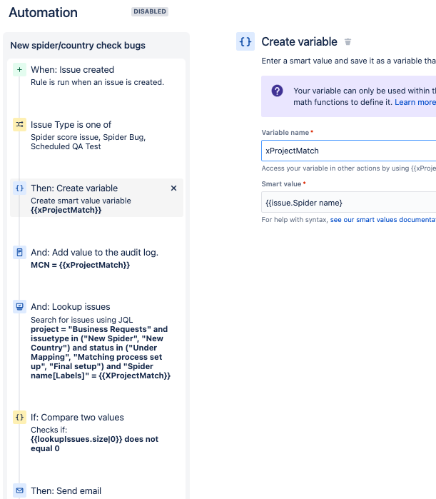

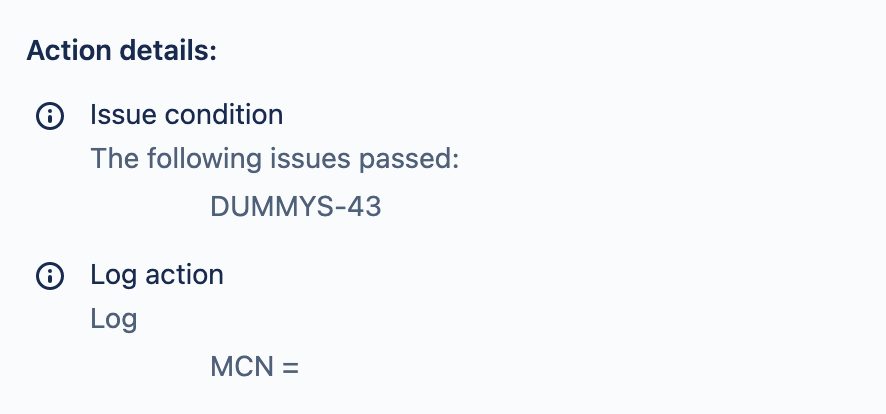

Hi @Jack Brickey ! finally I was able to created but the variable is set as empy but the custom field has value, not sure why. See next screenshots of the issue created and the log:Captura de Pantalla 2023-02-28 a la(s) 10.30.38.png

Jack Brickey
February 28, 2023
Please share your rule.
Sara
February 28, 2023
Jack Brickey
February 28, 2023
Can you add an Audit log action right after the trigger that logs the value of your custom field - {{issue.Spider name}}
note, you need to be sure that the custom field name is precisely the same including capitalization as your custom field.
retest your rule, and let's assess what that value is.

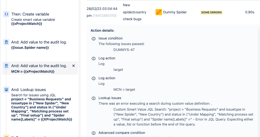

Sara
February 28, 2023
Sara
February 28, 2023
I got it!!! thank you so much for all your help.
Now I just trying to set the proper email with all the information needed. Just a last question ( I promise!) is there a way to get the issuekey from the results of the lookup issues to add it the email? I've never used this option before. Thanks a mil again!

Jack Brickey
February 28, 2023

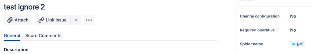

ok. in that image it appears that the variable now has the expected value. Before that was not the case. Now the issue is in the lookup issues. For test purposes, could you simplify that JQL as follows
Project = "Business requests" and "Spider name[Labels]" = {{xProjectMatch}}
I am just trying to zero in on where the air might be. Also let me verify that your custom field is precisely named Spider name[Labels]. Is the [Labels] part of the name? Would you mind performing the JQL search below in the Advanced search issues view?
Project = "Business requests" and "Spider name[Labels]" = target
I am assuming that some issues in the project have "target" as the value in your custom field.
