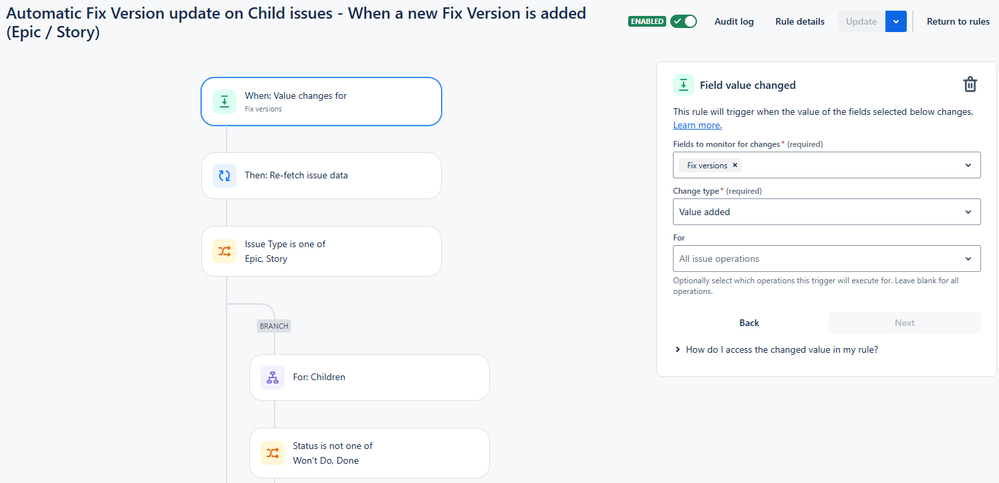

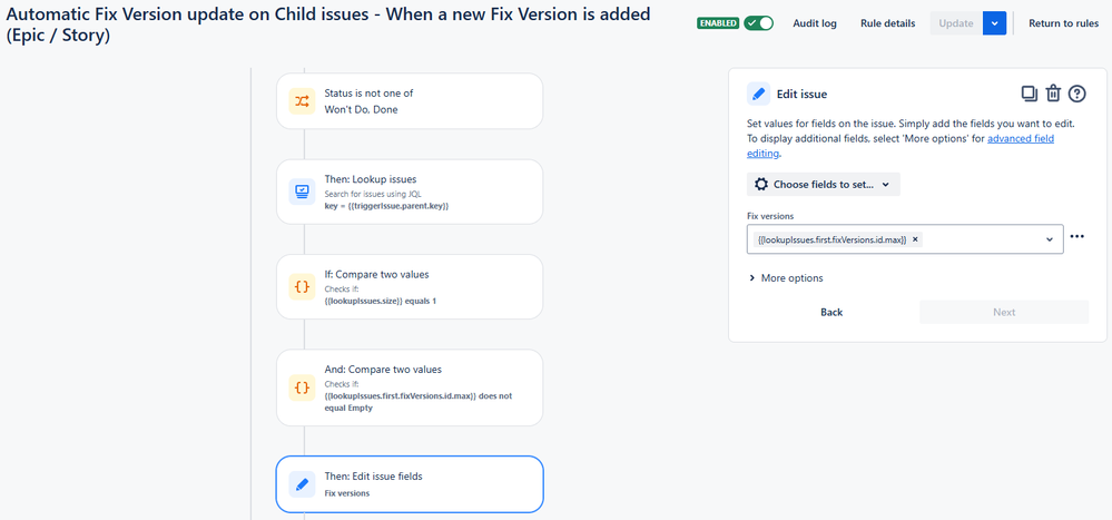

Christopher Vickery
April 2, 2025
Hi @Bill Sheboy
Thanks for responding so quickly.
I've created the rule and it's nearly working how I would like.
When I add a new Fix Version to the Epic, the Child issues that aren't 'Done' or 'Won't Do' have their existing Fix Versions completely replaced with the Epic's latest Fix Version using {{lookupIssues.first.fixVersions.id.max}}.
Are you able to recommend how any child issues that aren't 'Done' or 'Won't Do' will keep their existing Fix Versions (if they have any) and have the most recent Fix Version on the Parent added?
The rule I've created is below:
Thanks again for your help and let me know if you have any other questions.
Chris
Bill Sheboy
April 2, 2025
To add a Fix Version value rather than replace them, please use a JSON expression:
  • in the Edit Issue action, remove the Fix Versions field selection from the dropdown list
  • in the More Options, Additional Fields, enter this dynamic JSON expression:
"update": {
"fixVersions" : [
"add": {
"id": "{{lookupIssues.first.fixVersions.id.max}}"
Like • Christopher Vickery likes this
Christopher Vickery
April 4, 2025
Works perfectly. I need to familiarise myself with JSON. Appreciate your help Bill :)
