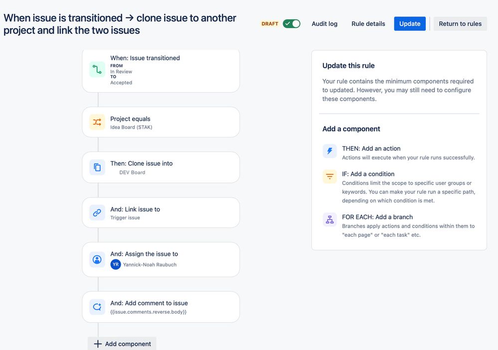

Hi all,
I tried to find a solution over the community but I am still struggling. I hope someone can guide me or can give me any tipps. Maybe I am too blind to see the solution myself.
We are working with two JIRA boards,  Idea board and dev board. When a ticket is moved on the idea board from "in review" to "done" with status accepted, I wanted the automation to clone the issue onto the dev board, link the two issues and clone also all the comments.
All is working except for the Link issue to and the add comment to issue. The automation creates me a Clone ticket on the new board but I do not get a link to the root issue nor are taking any comments over...
What am I missing? Is my approach somehow wrong? Thanks in advance for the help. Very much appreciated.
With best regards,
Yannick

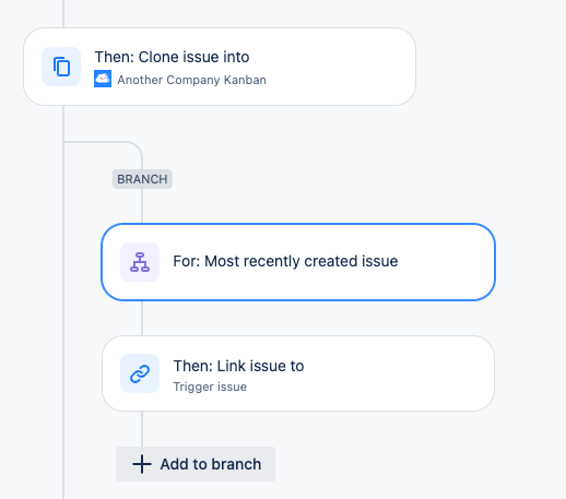

The reason your rule is not linking the trigger issue to the newly created issue is because of the context.
At the point you are executing the Link Issues action, the issue context is still the trigger issue. So the action is trying to create a link to the trigger issue from the trigger issue.
To create the link between the Clone and the trigger issue you need to do this to change the context/focus to the newly created issue:
You will need to add the Assign action and the Comments action within that branch also.

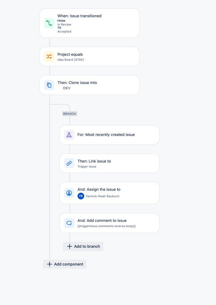

Yannick-Noah Raubuch
February 12, 2024
Hi both,
thank you so much for the answers. I changed my automation now to this. I included a separate branch and changed the information in the comment to triggerIssue...but somehow, the automation seems to work (no errors) but I am still not getting the link between the tickets and the comments.
Is there anything else I need to give permission or so?Screenshot 2024-02-12 at 10.45.51.png

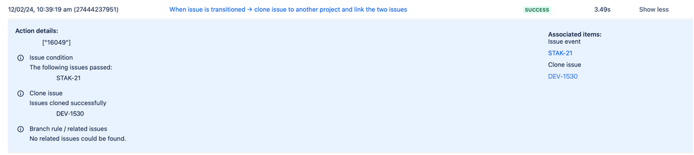

@Yannick-Noah Raubuch would you please post an image showing the audit log details for the rule execution?  That may provide some explanation of what is happening.  Thanks!
February 15, 2024
@Bill Sheboy thank you. I hope this is somehow useful:
Bill Sheboy
February 16, 2024
Ah...the issues are in different projects.
I hypothesize you created this rule in a single project, and so it has a single-project scope.  Rules in one project can create (or clone) issues into other projects, but they cannot see or edit them otherwise, and linking is an edit (i.e., both issues in the linking change).  As the log shows, the branch did not find the issue as it is outside of the project.
