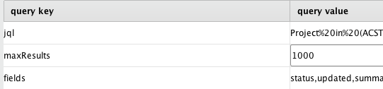

Sorry I'll try and provide more context.  I am using a an ETL tool called Rapidminer to acess the JIRA Api.  I've pasted a screenshot of the 'query' operator.

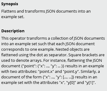

I then have to use another 'operator(function)' to convert it from 'JSON' to a format that I can work with.  From there I do other adjustments to the data but those 'field' names already come through like the photo I posted initially.
