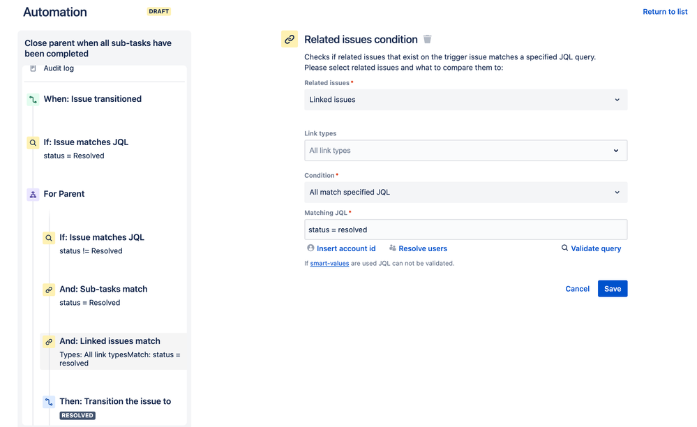

You should be able to pull this off using a rule like this:
Trigger the rule when a sub-task transitions to closed (the example is based on the template library and statuses / conditions do not match your use case 100%, but the essential pieces are there).
You may want to add a condition in the beginning to see if your trigger issue is a sub-task.
You can create a second rule for standard issue types (i.e. issues that are not sub-tasks) and replace the For Parent branch with a For linked issues branch using more or less the same logic.
Hope this helps!

Hi @Walter Buggenhout  - Got an issue buddy! If i close the linked issue last nothing happens (not even registered on automation audit log. Where as if a close the sub tasks last the automation works. Any thoughts? Thanks in advance
Darren.Fairweather
April 14, 2023
@Walter Buggenhout  yeah its does not like the linked match.
Error searching for related issues. This is most likely because the following issues don't have a related issue of the type you specified. Try narrowing your search to only include issues that contain links to related issues:
NTT-29774: "(((key = ) AND (issuetype = Onboarding and Status = "Build / Configuration")) AND (key != NTT-29774)) AND (project in (10064,10001,10037))" - Error in JQL Query: Expecting either a value, list or function but got ')'. You must surround ')' in quotation marks to use it as a value. (line 1, character 10)
Darren.Fairweather
April 14, 2023
As you say seems like i need two rules. One using parent for subtasks and one "for linked issues". Trouble is i only want the automation to trigger when sub tasks and issuelinks are complete and not being able to add both in the same rule using an "and" scuppers that?
