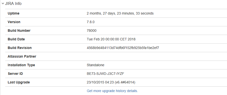

Andy Heinzer
July 23, 2018
Hi @Elvis Haračić
In reviewing your logs I found that Jira  7.8.0 appears to be starting, however I also found this detail in the latest startup.
Database Version       : Microsoft SQL Server - 10.50.6000
Database Driver        : Microsoft JDBC Driver 6.2 for SQL Server - 6.2.1.0
That database version corresponds to a MS SQL 2008 database.  This database version is actually unsupported in Jira since 7.2 versions and higher.   As a result, it is likely that your data has not been fully upgraded to the Jira 7.8.x structure of the database layout yet.

Elvis Haračić
June 18, 2018
Please find attached the screenshot.
Regards,
Elvis
Nic Brough -Adaptavist-
June 18, 2018
The layout looks a little different to mine, but that should not stop us.  At the top of any of the admin pages there should be a search - if you put "priori" into it, does it suggest "priority schemes"?

Andy Heinzer
June 18, 2018
It looks like you upgraded directly from Jira 6.4.  This could be a problem since there is an expectation that all Jira versions older than Jira 7.0.x should be upgraded in a path that goes through a 7.0.x version.
It could be this is something a Jira admin can't be, but a system admin can see.  However if you are logged into Jira as a system admin, then my concern would be to see your logs from the time of this upgrade.   I suspect you might have one or more upgradetasks that did not complete as expected.  In support we have seen a number of cases have this happen when the version of Jira you are upgrading to does not have support for your specific database version on the back end (for example MS SQL 2008 or earlier versions were known to be unable to run the upgradetask in Jira 7.4 for the kanplan feature.
Would you mind creating a support zip from this Jira site and posting a link to it so we can take a closer look?
June 18, 2018
Jira 7.6 and above all have priority schemes - could you show us a screenshot of where you think it should be and confirm the version of Jira and Jira Software from the system info page?
