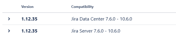

Last question, what is the difference between the DC and Server downloads?
Trudy P Claspill
May 15, 2025
Download the one that matches your product license.
If you are running with a Jira Server license, download the one for Server. If you are running with a Data Center license, download the one for Data Center.
You can view your license type from the System administration area, under Applications / Versions & Licenses.
