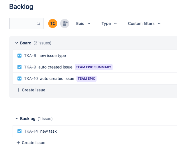

If you are working with issues in a Team Managed project, a board is automatically created for such projects when you create the project. For Team Managed Kanban boards, the difference between an issue being "in the backlog" vs. "on the board" is not based on the Status of the issue. Any issue in the Team Managed project can be either "in the backlog" or "on the board" regardless of Status. Issues are moved onto the board when you drag and drop them from the Backlog list to the Board list.

For more information on Kanban backlog for Team Managed projects refer to

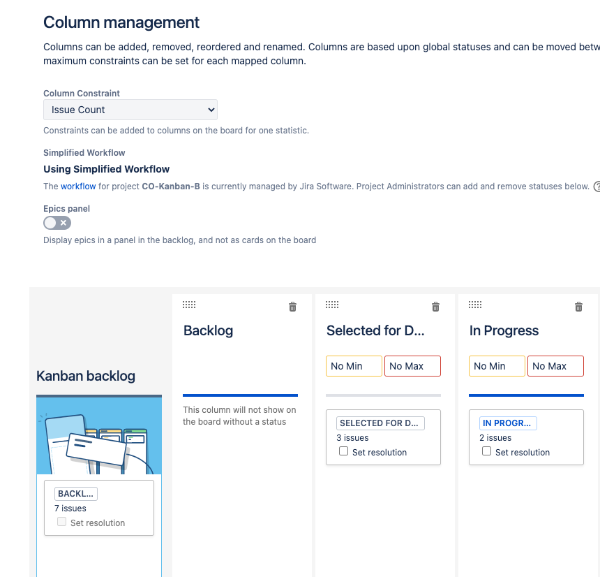

For a Company Managed project Kanban board you choose issue Statuses to indicate issues are "in the backlog" versus "on the board". Issues are moved onto the board by changing the issue Status. The Column Settings for the board is where you map statuses to the Kanban Backlog vs. the columns that display on the board.
