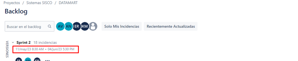

Antonio Burgos Vieyra
July 5, 2023
I want to copy these two dates into fields within the incidents, in order to make a report. I have already validated all the incident fields in the report, but that data does not appear.
