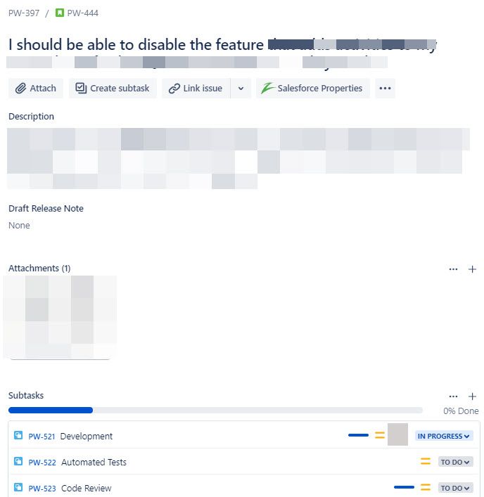

-There are tasks on stories

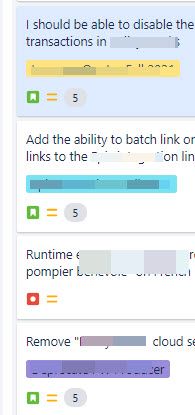

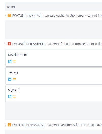

What we want to see : (story then subtasks grouped)
What we actually get : (just the story cards)

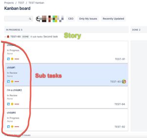

Something isn't adding up because what you want to see, I think, is what you should see. If you do swim lane by stories you should see the story at the top and all of his children listed within the swim lane. Just to be clear in the image that you presented that's what you actually see do all of those issues have some tasks? Here is an example of what I see in my CMP test project...

This has been resolved- it ended up being that they did not add the team name to the sub-tasks; once they were added it filtered correctly.
