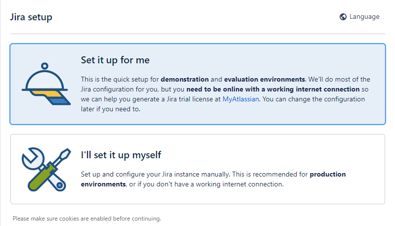

When you create a new database, setting the collation has nothing to mess up yet. There is no data in that new database yet. The setup wizard of Jira will only appear when Jira is configured without any database, or the database it is pointed to is empty, and in turn it has to create the tables it will need when starting up.
If you're in that setup wizard, you should see a link called 'import existing data' (sorry I think I got the exact title wrong on my last post). You need to use that to get to the import wizard. If you are in the setup wizard and you get to a screen prompting you for the admin username, admin full name, admin email, and password, then you have gone too far. The link for the import is on a page before this. There is also a KB about this in Importing data via Setup Wizard that might help.
This wizard importing your xml backup won't muck anything up. All your data will still be there, just this time in a database setup that Jira is actually expecting it to be in.

Whenever I create a new empty database, new creds etc...I change the location of the db and all the required information. I check the dbconfig.xml, and everything looks fine. After starting up JIRA again, I get a message with the same error as before speaking about character set and collation. I have backup my dbconfig.xml and deleted it, and when doing so I finally was able to get back to the setup wizard. When I follow your instructions above, there is no button for "import existing data".

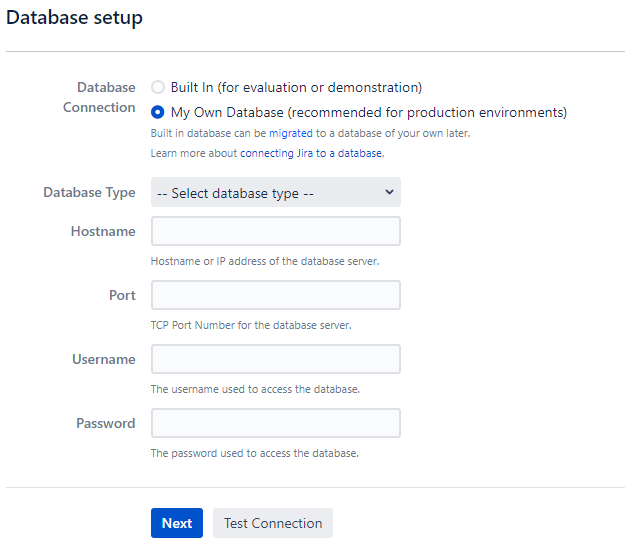

As well if I go back one step:
I found a workaround but its sloppy.
-if I edit the dbconfig.xml to show the db version is just mysql and not mysql57, run the setup wizard it will start to import jira tables. GREAT! I have done it...WRONG.
-Even though I was able to change the character set/collation to the "correct" utf8mb4/utf8mb4_bin, and import all my data to that new db. I thought hmmmm...lets change the dbconfig.xml to mysql57, and starterrrup....back to same error.
