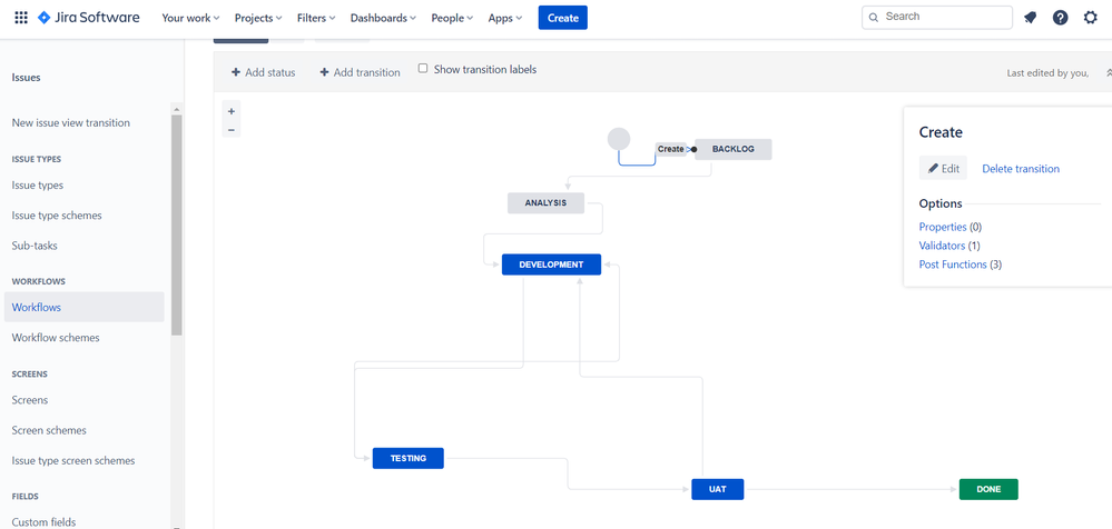

2- all transitions in the workflow are free from properties, Triggers, Conditions, Validators. All have Post Functions (5) though - not sure what that isUntitled.png

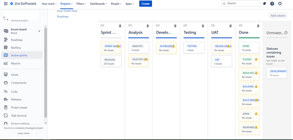

Also the issue might be from "column management" - there are some issues here but I do not understand. Any way you would be able to help me with this?

Ok, the diagram shows that you do not have transitions between most status.  As you say "no conditions, only post functions (5 is standard for an uncustomised transition)", let's ignore them.
Your workflow has transitions
Create -> Backlog -> Analysis -> Development -> Testing -> UAT -> Done
Mostly a completely one-way linear workflow.  It does have two other transitions - you can go from Testing and UAT back to Development.
But there's no transtions from Backlog to Development/Testing/UAT/Done, and so-on.
Your column configuration then makes it worse, because "Development" is not mapped into any columns, you can't actually use Analysis -> Development, Testing -> Development or UAT -> Testing because there's no column for it.

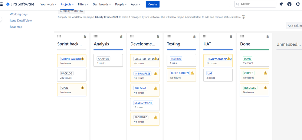

The quickest one to fix is mapping "development" into the right column on the board, so people can start moving through the workflow, it'll take only a minute to pop in and do that.
The rest of it is, yes, editing the workflow.
Before throwing yourself into it, have a think about exactly how you want it to work.  Do you really want "any status to any status"?  For example is UAT to backlog a valid thing to do in your process? (Not unusual to have "failed a UAT test, throw it back into the backlog so the scrum team can pick it up in the next sprint")   Or Done to Development? (Much less likely, you'd probably want to re-open stuff back to the backlog or analysis, so people can analyse why it's needed to be re-opened)
In other words, have a run through mapping your desired transitions, and then, yes, add them into the workflow.  You'll probably want to think about conditions too - would you want to allow anyone to throw something out of testing back into the backlog?  Maybe that should be only the team, and not the end-users who originally created the story?
Once you've mapped the from-to pairs, have a quick look at each status and how people get there.  You might well find, for example, that you have a transition from any status going into "done".  In which case, do not add a pile of separate transitions, add a "global" transition into "done" - it'll show as a small black box with "all" written in it, pointed to "done".  If you do decide "can go from any status to any other", you should also use "all", just having each status with a single All -> Status transition for each status!

I had some issues that now I cannot see on the board, 11 out of 15 of them. Not sure what I did. :/
Nic Brough -Adaptavist-
November 4, 2021
Ok, I'm assuming you've mapped "development" into the column by the same name?
So the next questions on "missing issues" are
  • Are the missing issues in the current sprint?
  • What type of issues are missing (I mean the "class" of issue in the hierarchy, not the actual issue type - are they at the Epic layer, Issue layer, or sub-tasks)?
  • What is the board filter?  (You can see it in the board "general config" section, which is just off the top of the screen in the view of the column mappings you gave us earlier)

1. Yes, in the current sprint 2. Issue layer 3. What should be the filter?
November 4, 2021
I don't know what the filter should be, can you share what the board general config says it is?  (Feel free to scrub project names or other local data you don't want to share, we're only interested in the clauses, issue types and field selections)
Simon Sefilian
November 4, 2021
Filter: Organization's board
November 4, 2021
No, sorry, we need the actual JQL of the filter - it should be under the name of the filter.
Simon Sefilian
November 4, 2021
project = ORGANISATION ORDER BY Rank ASC
November 4, 2021
Ok, so the three missing issues are in the project keyed "ORGANIZATION"  then?
Simon Sefilian
November 4, 2021
Yes, all the issues the present and missing ones "organisation" - XYZ num
Simon Sefilian
November 4, 2021
I can see all now and can move the issues to any status. Thank you
