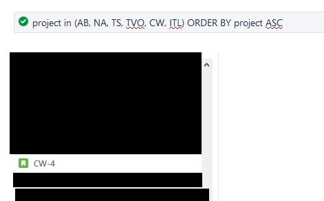

Issue Found inside of Filter powering combo board:

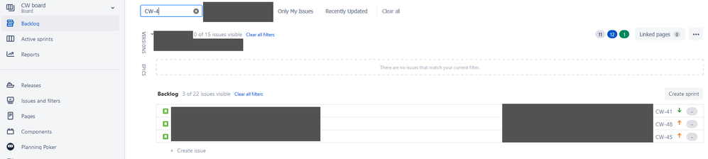

Issue not showing when searching the projects own backlog:
To be clear there are no other filters on this board aside from the default.
