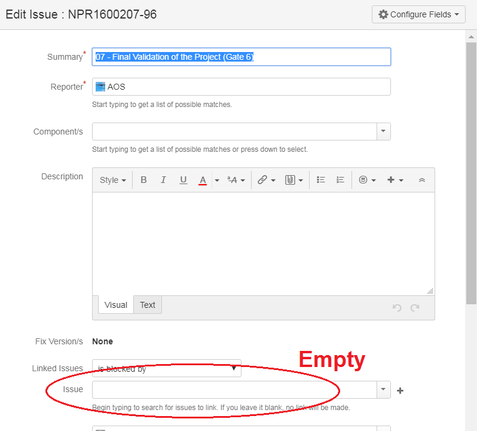

The problem is that when I edit the issue, I can not see the linked issue anymore (the "issue" sub-field of "Linked Issue" field is empty).
I have observed that this problem exists also for different link type (e.g "blocks").

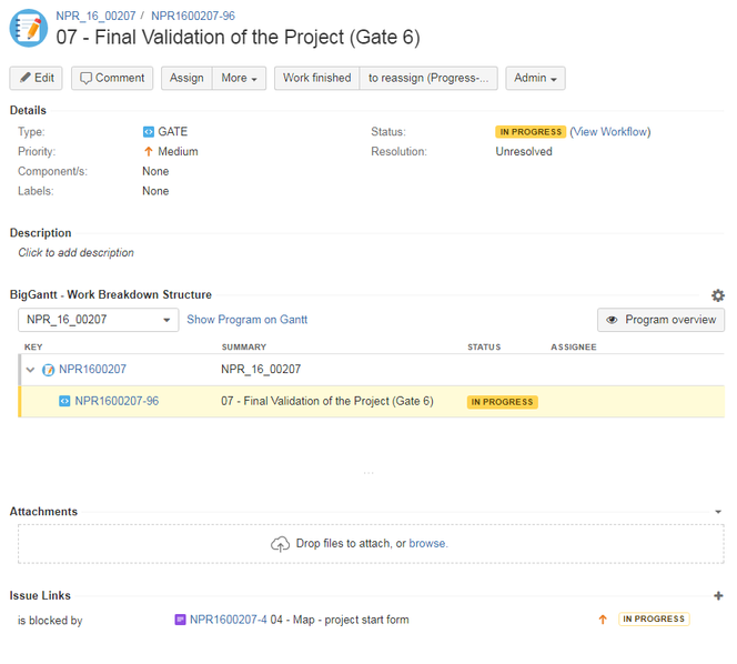

Step1: assign linked issue as "blocked by":
Step2: verify that the link configuration has been acquired:
Step3: edit again the issue and the link is no more present

I third what Alex and Piotrek said.  AND you will NOT see the link on the JIRA View Issue screen , within the BigGantt WBS section.  You will see the link on the JIRA View Issue Screen in the Links section (but ONLY if you have added the Links section to your screen configuration/schema).
The only place you can see the link inside BigGantt is by clicking on the issue and getting the popup box that shows the details of the inbound/outbound links for that issue.
And even then,you would have to configured BigGantt to use the link type 'blocked by' as one of it's mapped link types.

The Edit screen shown in step 3 will not show any previously linked issues. This "Linked Issues" field in the Edit or Create screen only provides you with the ability to create new links, not edit existing links.
I have not used BigGantt personally, but I'm assuming you can probably edit the existing links in the BigGantt section seen in step 2 from your original post.

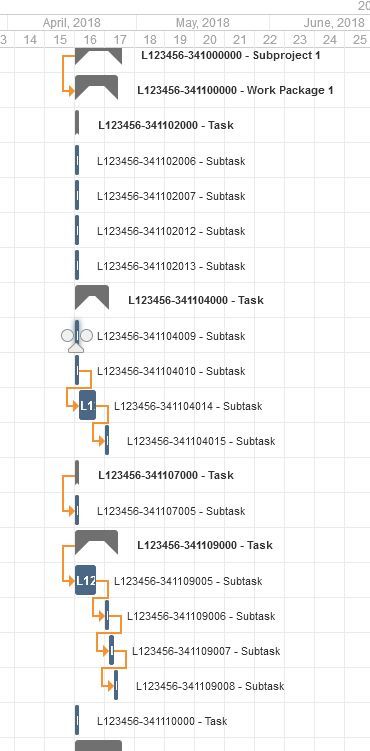

Here are three Screenshots which shows the Issue. The first one shows the Gantt-View. In the view you see that not all issues are linked. We have links on all levels shown (Subprojekt-, Work Package-, Task- and Subtask-Level)

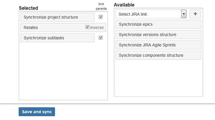

The Jira-project is imported via CSV-Import. Columns of the CSV-File are mapped to Gantt Start to Start and Gantt Finish to Start Link respectively. We use the following Synchronizers for the Gantt-View (see Screenshot 4)

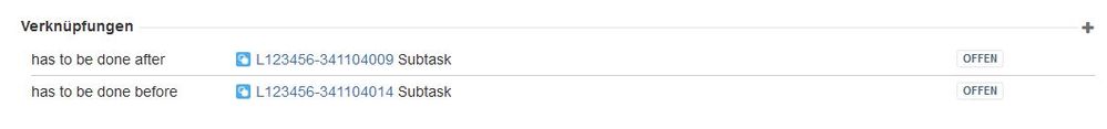

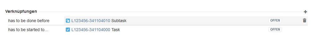

Links between Issues are correctly identified in Jira. (see issue details of subtask L123456-341104009 (2nd Screenshot) and L123456-341104010 (3rd Screenshot)
In Task 341102000 No links between Subtasks are displayed in the Gantt View althoug shown in the issue details. In Task 341104000 Links are shown between subtask expect first subtask.
What can we do to get all links between issues showns correctly? We already tried to

On your 3rd screen shot, I can't see the entire Issue Detail screen, you only screenshotted the 'Issue Links' section of the screen.  Let's see the entire screen. What is the Issue that the links are assigned to?  4000 and 4010 are not linked to one another, they're both linked to ?? need to see the rest of the screen.
Are these tasks linked to some other task that is not in your Gantt? if you send the whole Issue Details screen maybe we can see what is going on.

I do second what @Alex Christensen wrote. The screen which you are viewing is the issue 'edit only' menu. As BigGantt uses simple Jira custom fields for its purposes, links in our plugin will also be respected once added, though will not appear in the 'edit mode'.
You may visit our Wiki to learn more about BigGantt's dedicated custom fields and issue links ad well as linking tasks on the Gantt chart.
