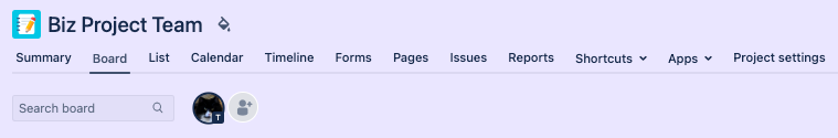

Are you working with a Software project, a Service project, or a Work Management project? If you have navigation options across the top of the screen like below, then it is a Work Management project.
If it is a Work Management project and issues are "disappearing" only from the right-most column, or only from columns that have green statuses mapped to them, then be advised that green/Done issues will be automatically hidden on the board when they have been in that status for 14 or more days.
