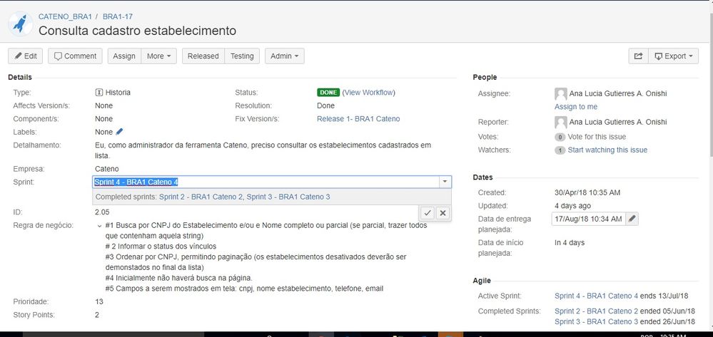

When closing the sprint, it informs that there is no one in done.

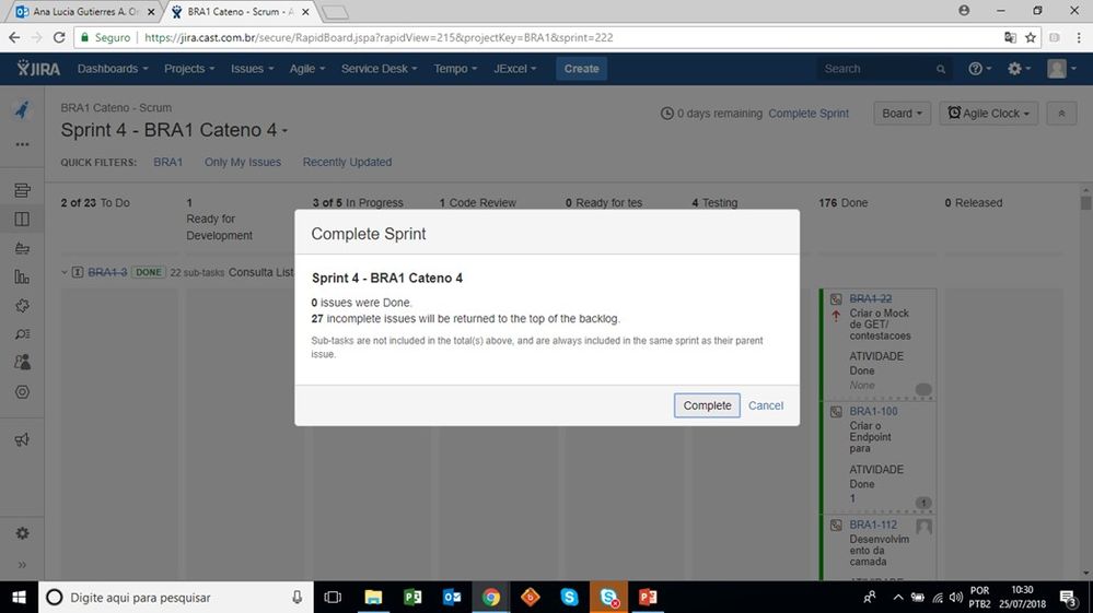

The screen below, where, when executing the "Complete Sprint" button, it shows the message that "0 issues were Done" exists.

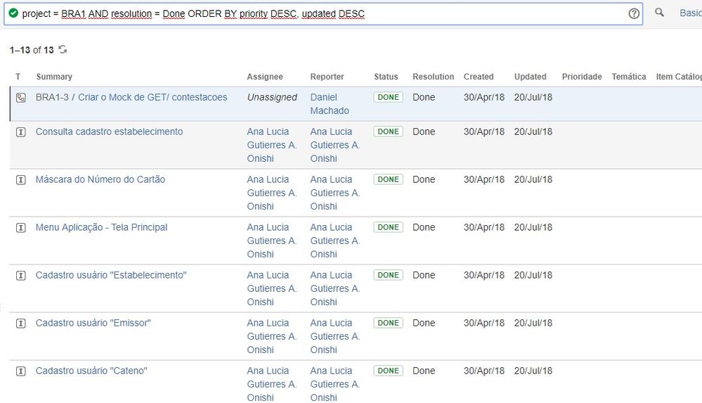

In a scrum board, an issue is considered DONE only after it reaches the right most column. Not when a resolution is added to the issue or when it reaches a status named "Done".
In this case, you have to map "Done" status to the last column on the board.
I needed to put all the stories in the last created status. In this case, it was not "done." It was "Released".

@matheus nascimento camargoI see 0 days remaining to complete sprint, so most likely you did not close any issue before you time elapsed.
Best!
Hi, thanks for your reply, but I finished in that elapsed time.
