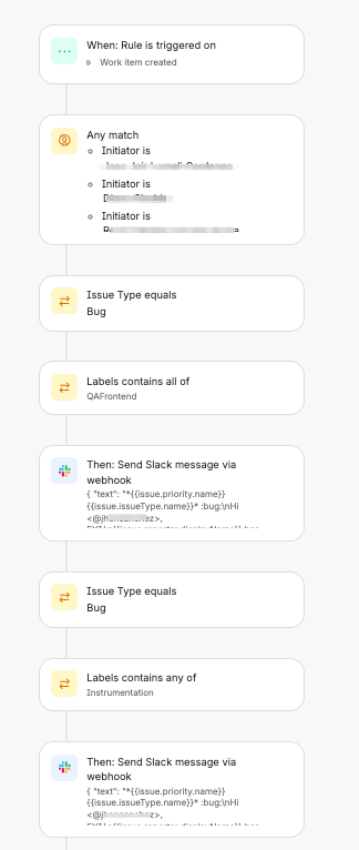

I am trying to create a very basic rule in Atlassian with a condition based on the issue label and work type, but for some reason the automation does not recognize the second condition
This is what is happening: I created a rule where, when a bug is created with label A, the system sends a Slack alert via webhook to a Slack channel. The second condition is that when I create a bug with label B, the system sends a Slack alert via webhook to a Slack channel.
The problem I see is that the system is not recognizing the second condition. When I create a bug issue with label B, the audit log for the rule says that the work item does not match the condition, and it refers to the condition where the label is A instead of B. but when I create a condition with label A the rule works find.
I think there is something that I am doing wrong when building this automation. I asked Rovo, but it was not able to help. Can someone help me. Thank you.

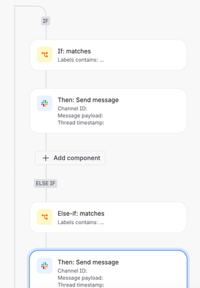

Hi Erika,
You need to use an IF/ELSE condition instead of a regular Condition for checking the label. The way you have it now, if the Label is B, it gets to the first condition looking for Label A and when that is not met, it just stops. Put in an IF/ELSE condition with the first IF condition being the check on Condition A and the ELSEIF condition being Label B.
You don't need the second Condition check for Bug because they has already been filtered out. Move the Slack message webhook actions under the appropriate Condition (A or B).

Erika Reategui
March 6, 2026

Okay, as I assumed the way you have configured your rule is that it will never reach label B because it will not get past the condition for label A. As @John Funk mentioned, you have to use IF/ELSE in order to do that, something like this:

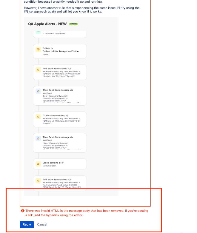

Thank you for your responses. It is very frustrating communicating here, I keep getting the following error message

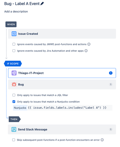

I’m Thiago, a support engineer at Appfire.
If you are considering using third-party apps, you could easily set this automation through JMWE(Jira Misc Workflow Extension).
Step-by-Step Configuration
Navigate to JMWE Settings > Event-based Actions > Create New Action.
Configure the automation for Label A with these parameters:
  1. When: Issue Created
  2. Conditions: * Project: Select your specific project.
  3. Issue Type: Bug.
  4. Nunjucks Condition: {{ issue.fields.labels.includes("Label A") }}
  5. Then: Send Slack Message
To handle Label B, you can simply repeat these steps and update the Nunjucks condition to look for "Label B" instead. We recommend selecting the target project instead of the default "any" for better performance. Below is a screenshot on how the setup should look like:
Please contact our support if you have any other questions about this.

From the audit log it looks like the rule stops at the first condition.
If the rule is structured like:
Condition → label = A Action → send Slack
Condition → label = B Action → send Slack
then when the first condition fails, the rule does not continue evaluating the next condition, which would explain why it always stops there.
