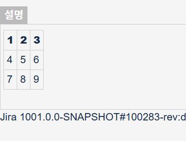

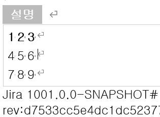

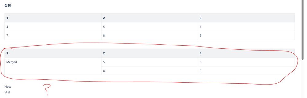

I created a table in the JIRA description field and merged cells to complete the table. However, when I print or export to Word, the merged table is not visible. Unmerged tables are visible. What is the issue?

Please note that Exporting Rich Text fields, such as the Description field in an issue, requires the conversion of an ADF document into its Wiki representation. This converted Wiki representation is subsequently exported into a .doc file format. It is important to note that merged cells within ADF documents cannot be accurately represented in a human-readable format in Wiki. As a result, when these documents are exported to the .doc format, the contents of tables with merged cells are removed. This occurs because the table structure becomes invalid and cannot be properly rendered.

This issue is not limited to PDF output; exporting JIRA issues to other systems also results in the loss of merged cell data. This is a serious problem as it leads to missing user data. When will this bug be fixed?
Although it was mentioned that complex table structures are not supported, merged cells are actually very simple structures. I cannot understand why this issue is being neglected.
