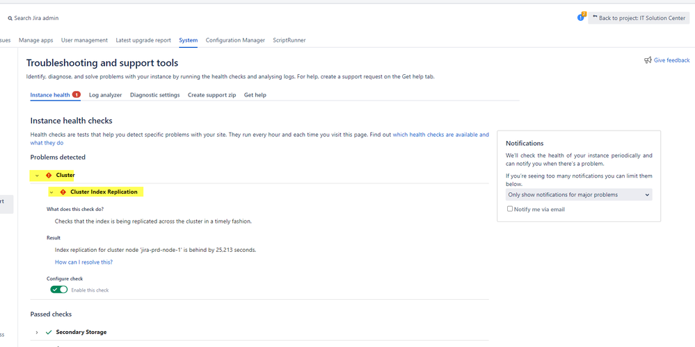

We are encountering an issue with Cluster index replication in our Jira Data Center environment, getting a message “The replication for cluster node 'jira-uat-node2' is delayed by 25,221 seconds”. Has anyone else experienced a similar problem? If so, we would greatly appreciate your assistance with resolving it.
Environment Details:
  • We recently migrated from Jira Server (version 8.20.9) to Jira Data Center (version 9.12.11).
  • Our platform migration involved moving from Windows Server 2016 (with SQL Server DB v13) to Linux (RHEL 7, with SQL Server DB v2016).
  • We have set up clustering with Docker containers (Node 1 and Node 2) for load balancing.
Current Issue:
It seems the cluster synchronization issue might be related to firewall port configurations. We have configured port 40001, but no traffic is detected (inbound or outbound). However, we do observe traffic on port 2377.
Has anyone encountered this issue or have any suggestions for resolving it?
