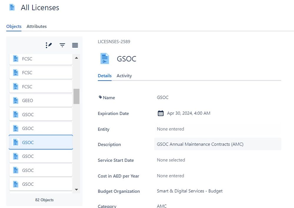

  1. Created assets (objects) named Licenses – this is where I need to pull the description and expiration date from:

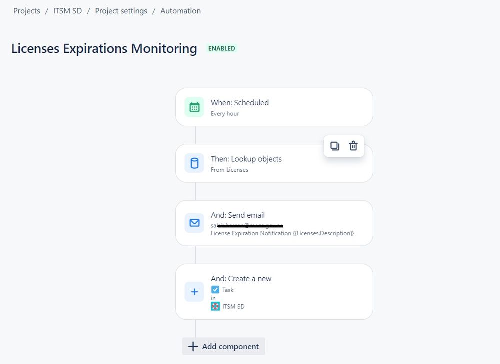

  2. Created the automation process to monitor licenses expiring as follows:

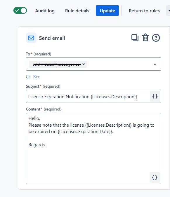

  3. Set an action to send an email when triggered with the note:

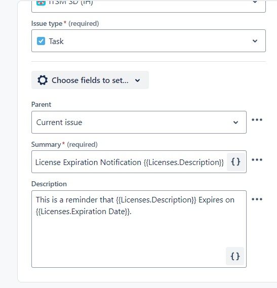

  4. Second action to create a task when triggered:

Hi @Salah Eldin Hassan, I see you are using a Lookup Objects action to retrieve items from your assets. Which is a good way to retrieve information from assets.
But if you then want to process that information, you need to refer to it, as mentioned in the smart values documentation.
That I mentioned License in my answer is just pure coincidence, as I was guessing from your question that you were trying to manage reminders for expiring licenses. But don't just literally copy what I mentioned there 😅 - I don't have access to your system and can't possibly know how you named things ...
If you can't figure out the right syntax from the documentation link (check the Lookup Objects section specifically), then it might help if you could share the details of your lookup objects action (step 2 of your automation rule). This can return multiple objects, so you may have to keep that in mind when processing the rule.
Anyway, you should refer to the results of your lookup action using {{lookupObjects. Description}} and {{lookupObjects.Expiration Date}}, considering you only get back 1 single result.

Thank you so much for the valuable hints! I’m happy to say I found exactly what I needed, and everything worked perfectly once I used the right syntax ({{lookupObjects.ExpirationDate}} & {{lookupObjects.Description}}).
Thereafter to ensure I’m only getting expiration dates for licenses expiring in the next 30 days, I updated the query to:
"Expiration Date" >= now() AND "Expiration Date" < now(30d) AND "Expiration Date" > now(29d)
