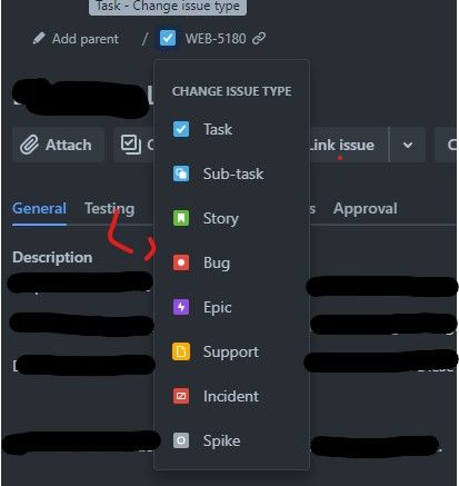

I am having an issue where I want to change the issue type for an issue.
It is no longer possible to change the issue type directly from the Icon when viewing an Issue. Specifically I want to change a Bug to a Task.
Interestingly, I am able to change a Task into a Bug (by selecting the Icon), but not the other way around.

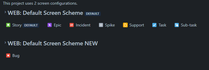

I also attached a picture of the existing Screens in case that might be useful information.

Hello @Rafael Freymueller ,
Have you checked that the "Issue Type" field is present on all screens (in this case, the one used by task, as Bug seems OK)?
Rafael Freymueller
May 23, 2024
Thanks that solved the first issue of not being able to change the issue type directly through the Icon!

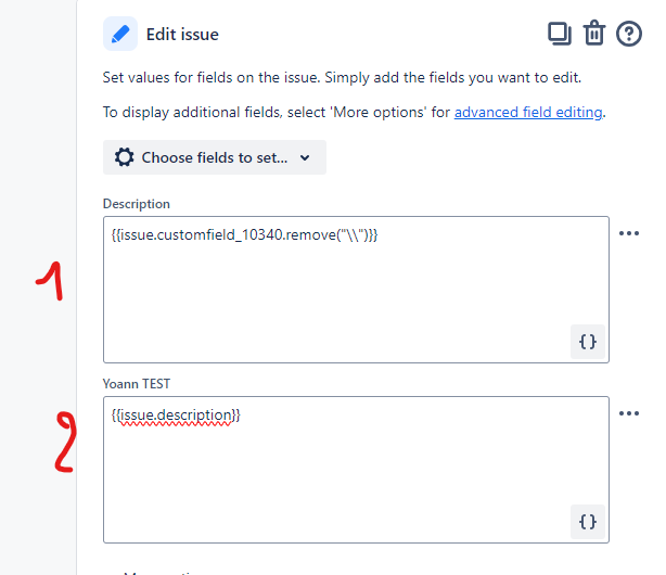

The only issue left would be that the content of the Bug description is 'lost' / not showing up in the Task after moving it. Would there be some way of implementing an automation for that specific use case? Or any other alternative really.

"Move" feature keep issue description.
Have you check if field "description" is correctly in the view screen of Bug ?
 If you use another field for Bug description, , Automation can help you :
1: I copy the description field into my customfield
2: The opposite.
