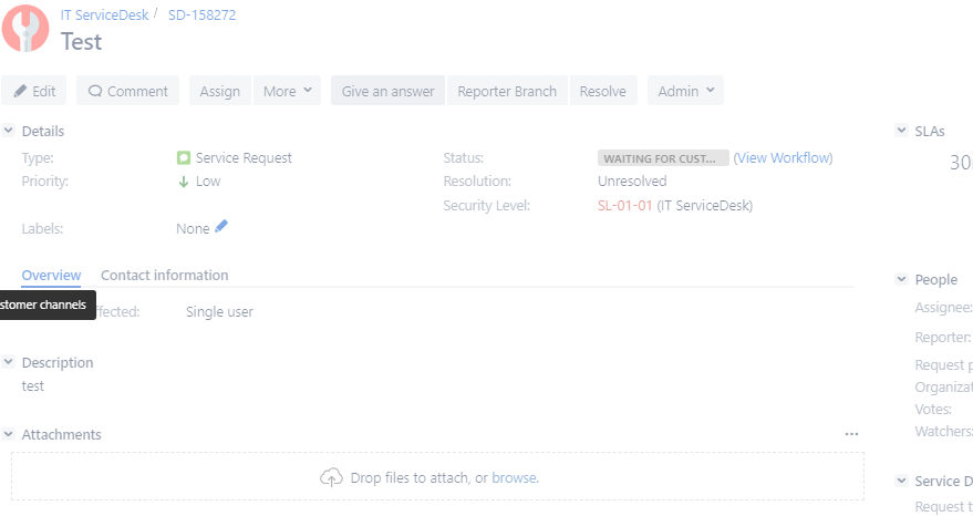

When I want to do some transitions it is updating very slowly.
For example I pressed "give an answer" and then it looks like faded:
Note: 1.It doesn't matter which transition I pressed. Problem is the same for all transitions.

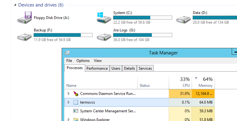

2.I check also disk space,memory,cpu I think everything is okay.

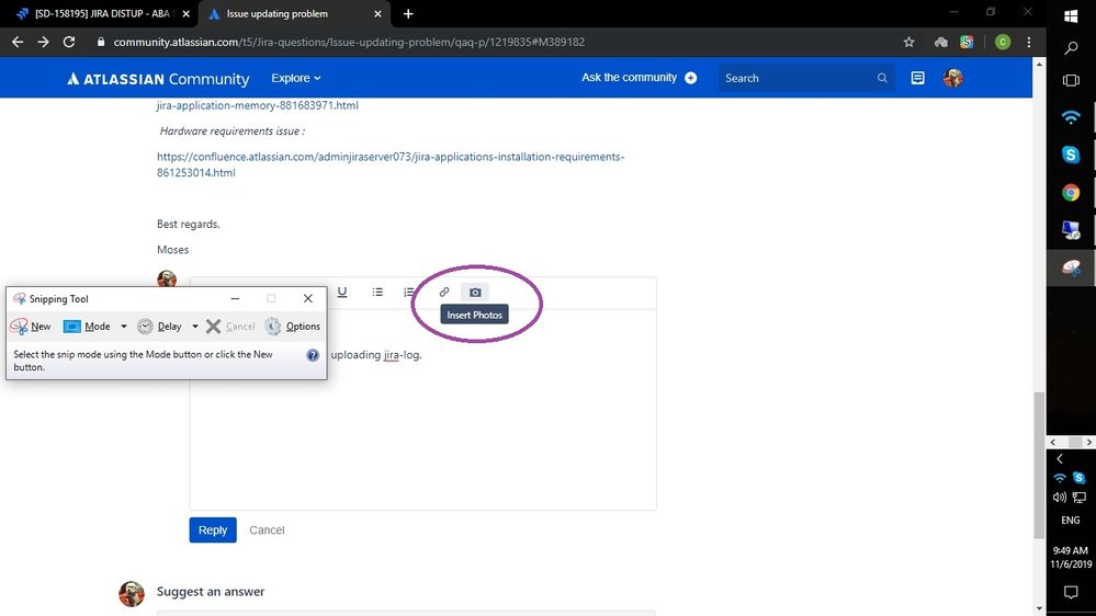

I can't attach file.
There isn't any option for uploading jira-log.
