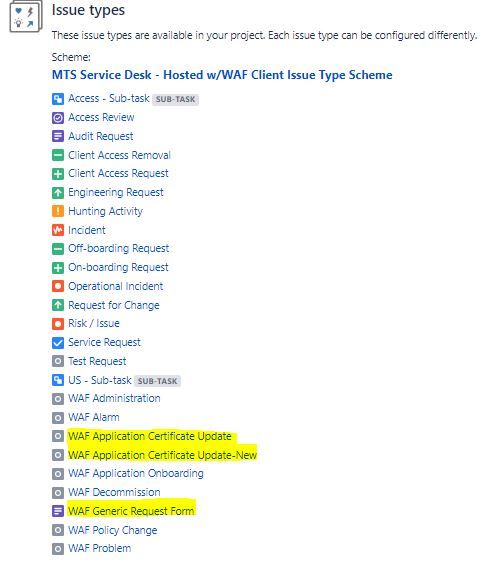

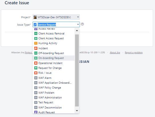

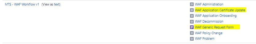

Are you able to share a screenshot of the projects issue type scheme and the create issue dropdown?
Nikhil
July 4, 2022
Here are the screenshots
Nikhil
July 4, 2022
Tom Lister
July 4, 2022
Thanks @Nikhil
That's a long list :-)
Jira dropdowns limit the number of results shown. Try typing WAF into the issue type field and see if a subset is then displayed.
Nikhil
July 4, 2022
I did try that and that was not the case. There was a script runner infact, that was working strangely. Found fix by adding these 2 issuetypes there. Thanks for your support guys!!
