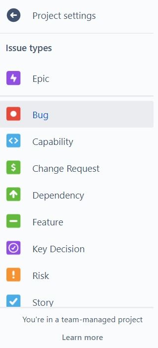

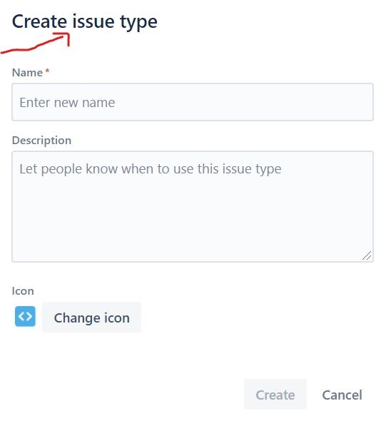

I am an administrator of a new instance of a 'Team Managed Software Project'. When I go to 'Project Settings/issues' to add the issue type 'Sub-task' I don't see an option of including a pre-defined issue type 'Sub-task' & if I add a new issue type 'Sub-task' it shows up at the level of other standard issues (Story,Tasks, etc) rather than appearing as the last layer (i.e. 3rd layer after Epic/1st-Layer AND Standard Issues/2nd-Layer).

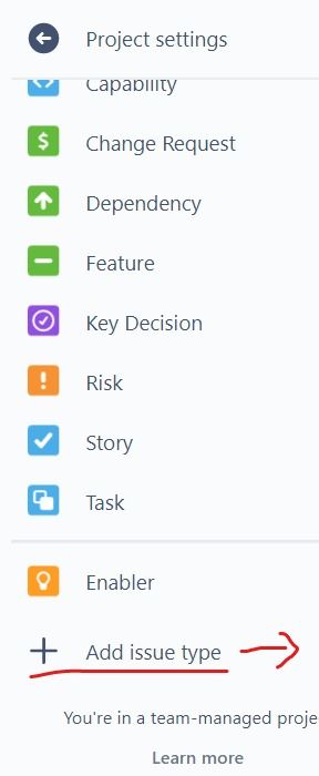

Ok, so your second screenshot tells us everything we need to know!
The shot with "project settings" at the top, then listing:
  • Capability (slightly cut off due to scrolling)
  • <some other types>
  • Story
  • Task
  • Enabler
  • + add issue type
  • You're in a team-managed project
It's the last four lines that say it:
Team-managed projects only support a single sub-task, you can't have many types of sub-task.
In this screenshot, note the line between Task and Enabler - that line is dividing issue-level types from sub-tasks, and Enabler is the sub-task type you've already added to this project.
Because you've got Enabler, and you're in a team-managed project, you can't add any more sub-task types.

Actually, no, you can just go into the "Enabler" and re-name it (click on the name at the top to edit it, and the icon if you want to select a new one)
