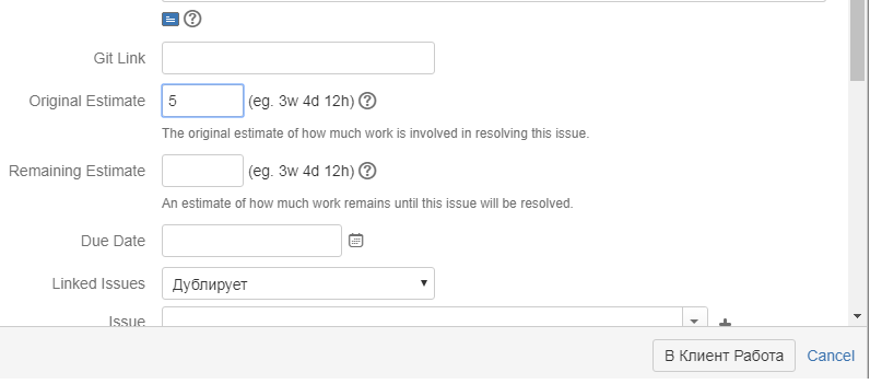

Here is how it looks like in the WebUI:
Do you have anny suggestions?
