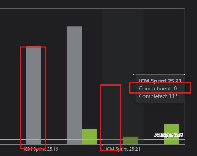

Good day!
I would like to seek your help as to why our last 2 sprints in the Velocity Chart report are missing inputs on Committed SP.
I am not aware of any changes in our board.
When I checked the backlog insight from the backlog view, it is displaying the committed SP for current (Which I assume it is the same for the previous sprints that we have).
We are using JIRA Cloud version.

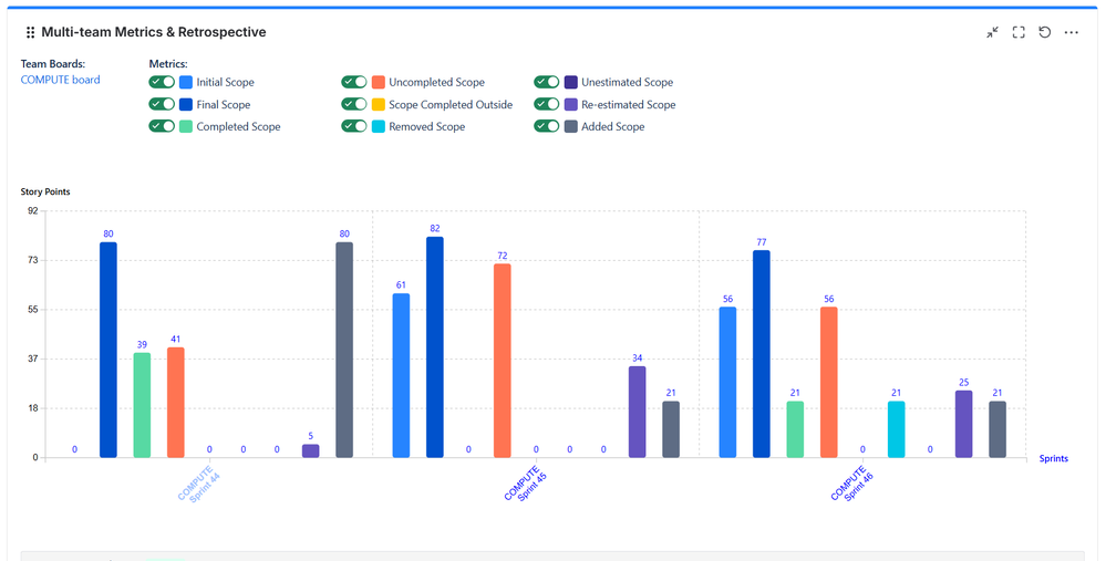

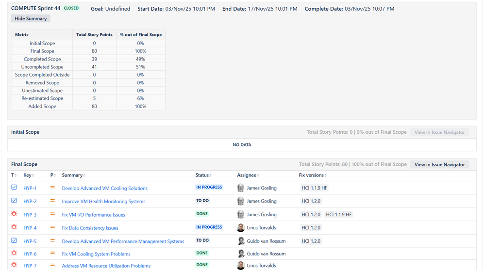

Most likely, you added scope to the sprint after it had already started. If that’s the case, you need to make sure the sprint is fully planned before it starts. Unfortunately, the Sprint Report doesn’t include a Final Scope metric. If you want to see the complete list of tasks in a sprint under a single metric, you can install the app I developed Multi-team Scrum Metrics & Retrospective.
With it, you will get the view below:

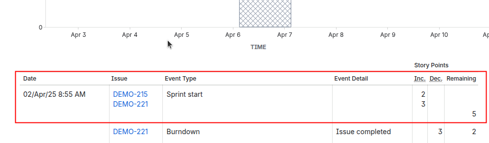

Look also at the Sprint Burndown Report for that sprint to see what happened and how the Remaining was when the sprint started. Last column indicates the Initial Commitment.

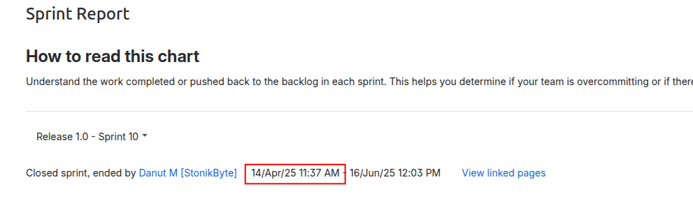

Also, compare this sprint start date with the start date from the Sprint report. They should be the same.

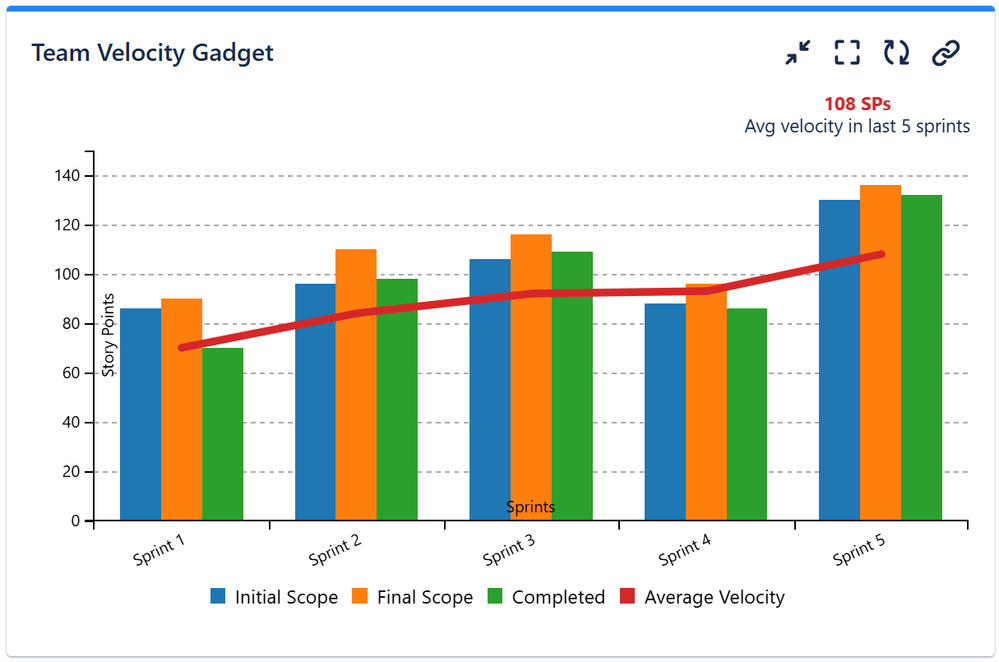

Another alternative would be to try an app (plugin) from the Atlassian Marketplace that provides a similar velocity chart. Our Great Gadgets app includes a Team Velocity gadget that may not experience this issue, as it works slightly differently from Jira’s built-in reports. In addition, it offers extra metrics such as Final Scope, which can be helpful in cases where the Initial Scope is zero.
