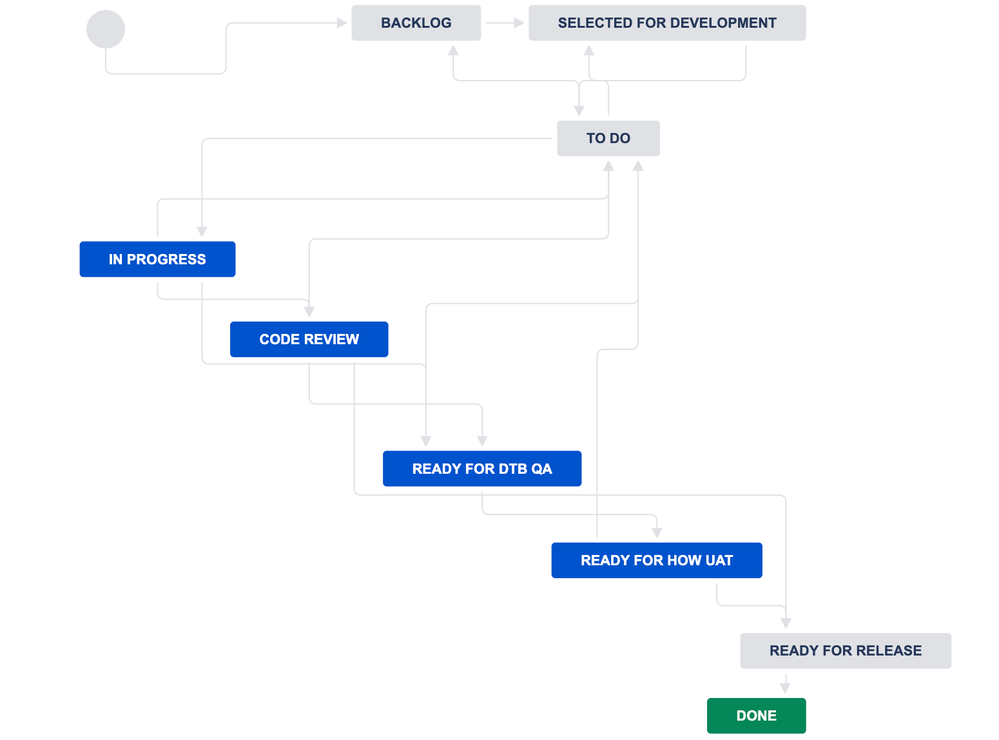

I've just created a new workflow, I've published it, however when it actually comes to moving a card on the Active Sprint board, this error message appears. Not sure why? Is this something to do with 'Screens'? Or something else?
I should be able to move it myself as I'm the system Jira administrator as well as Jira project admin. As you can see, I do have a transition from the To Do column to In Progress. :/

ok so your from status is to do. And indeed I see you have a transition from that status to in progress. Now please open the transition to in progress and let's inspect any conditions and validator's that might be present. Also are you able to make the transition from the detailed issue view? I'm just trying to rule out any possible board conflicts.
